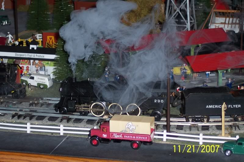

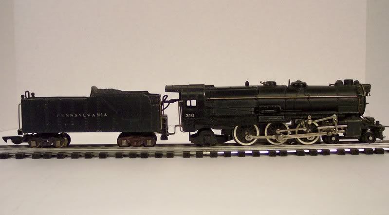

Thanks for the info! [:)] Are the Postwar American flyers better smokers then postwar lionel? Ive heard that a few times before but since my locomotive dosnt have a smoke unit I cant tell.
If you ever get to the York TCA show, you will find a ton of S gauge Flyer stuff. I’m not in S but like to look at it at the show. A lot of engines that are in very good shape.
In my 100% biased opinion, YES!
Here is one of my 21165 like your Casey Jones
There is a 21168 that looks like your Casey Jones but has a smoke unit
