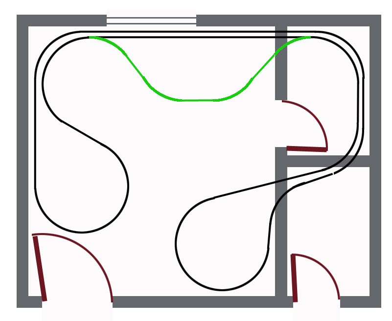

Here is my analysis of an HO continous route with 24" radius curves that will accomodate much equipment- some passengers cars, etc. No duckunders, liftbridges, etc. needed- inly “sepcial” construction would be some tunnel holes through walls, which can be tunnels, underpasses, etc.
I laid out a folded dogbone continuous route mainline with 24" radius curves. The green is an alternate route that allows some space in the middle of a wide section of shelf for structures, industries, etc. You can add industry spurs which will handle only a few cars and a switcher with 18 inch radius.
Note that you can easily follow a train around almost the entire circuit, including through the closet at top right of the plan. The exception is the short length through the closet at lower right. For the operator in the main room and attached closet, that short disappearance might represent a trip through a long tunnel. The short piece in the lower right room might be scenicked as a completely different place as a vignette viewing scene for railfans to see an occasional train pass. It would give you a chance to model an unusual scene you might not to use on the layout as a whole-- a snow scene, a desert scene, etc.
Where to put a yard? Perhaps across straightaway across top of plan.
Staging? A couple of deadend spurs might accomodate trains about 6 feet long to back either in or out in the lower right room, along the right hand wall. There is not room for them to enter forward, turn around and exit forward.
If the railroad is set at shoulder-high elevation (about 5 foot for me), the short section through lower right room can be on a narrow shelf that leaves 90% of the room open for ovther shelves and storage. Slightly less is up
