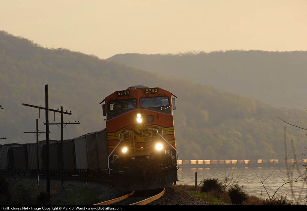

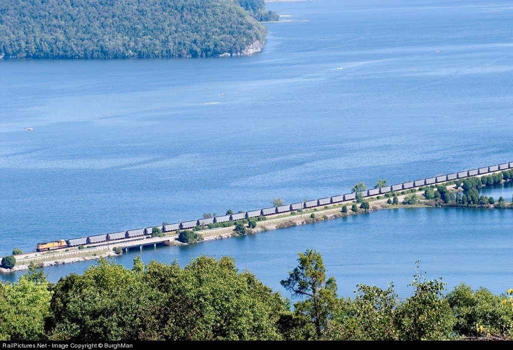

Ah we are very much on similar wavelengths here…the scene below (two different angles) is actually along the line I am modeling. This long causeway will flow completely around one of the horseshoes with nothing but the water to reflect the trains on either side:
Jamie
