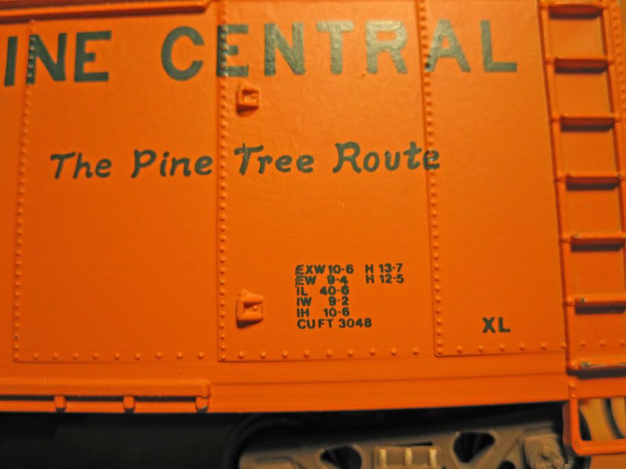

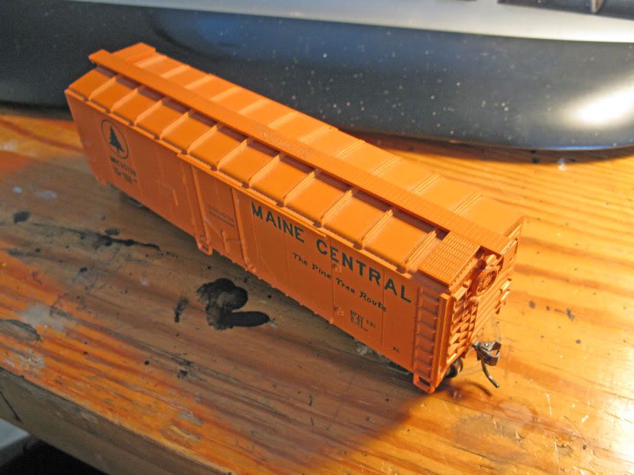

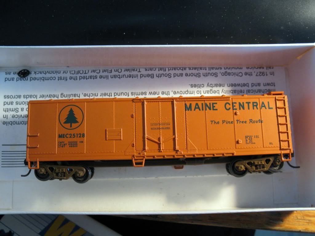

I’ currently doing my car inventory… I digged up this strange looking Maine Central boxcar that I found out at a flea market 4 years ago. It’s 40’ long, but the roof line is ver low.
Any idea about the manufacturer of this model? Roller bearing truck too???
And the time frame this kind of car was in revenue service? (I’d like to add it to my late 50’s layout roster, but I guess it’s pushing my luck too far…)
Thanks for any useful info.
Matt

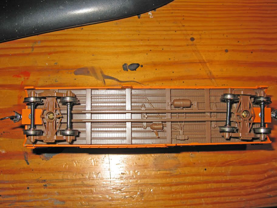

The paperwork in the box looks like a Walthers logo; could you photograph the bottom of the car? There are usually some telltale indicators there that confirm the manufacturer.
The car is too late to be a 50s box. It has no roofwalk and not many 50s boxes had plug doors. Look at the fine print on the car for BLT date - probably from the 60s or later.
It looks like an old Trains-Miniature/Walthers insulated box car. Note there are no ice hatches.

The car came into a Walthers box, but its not the original one. Trucks have real springs and details you wouldn’t find on Walthers cars. No building date…
@ Jim. True, proportions are similar to a 40’ steel reefer without hatches. Train Miniature could be effectively a good hypothesis. I’ll make take a look online. I guess it could be an early 1960’s car.

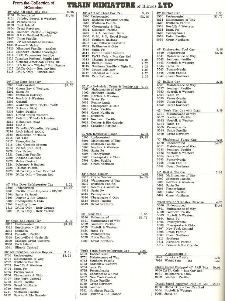

Train Miniature has this type of car listed in the 1980 Walthers Catalog. Although this road name is not listed. The numbers listed are 3300 to 3312 with 3319 and 3320 being new for 1980. These are Data Only cars that are painted reefer orange and reefer yellow.
These cars are listed as a 40’ Plug Door Reefer at $3.75 each. It goes on to say that a major design change for the standard steel reefer was the sliding flush door (“Plug Door”) in 1951. A new safety feature was the Blaw-Knox type roof walk.
Bill
Given the molded on ladders and blunt detail I think we can rule out Red Caboose. Might it be Train Miniature’s plug door boxcar model, which did in fact come painted Maine Central (3223) according to the list on HO Seeker?
http://www.hoseeker.net/TrainMiniatureslist/tmlist1981pg2.jpg

I’ve found a Walthers stock car which use exactly the same brown plastic underframe. I guess my model is from the TM dies but reissued by Walthers.
