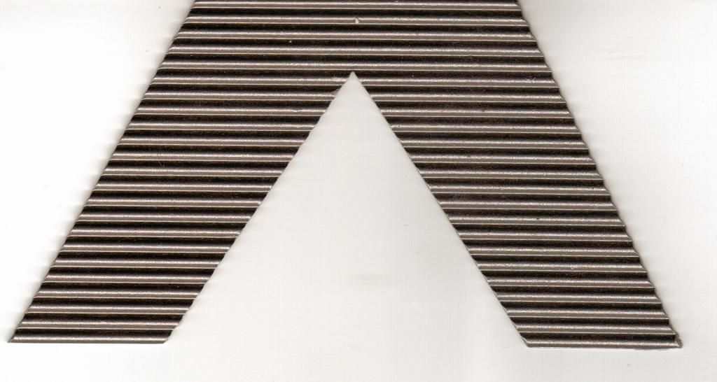

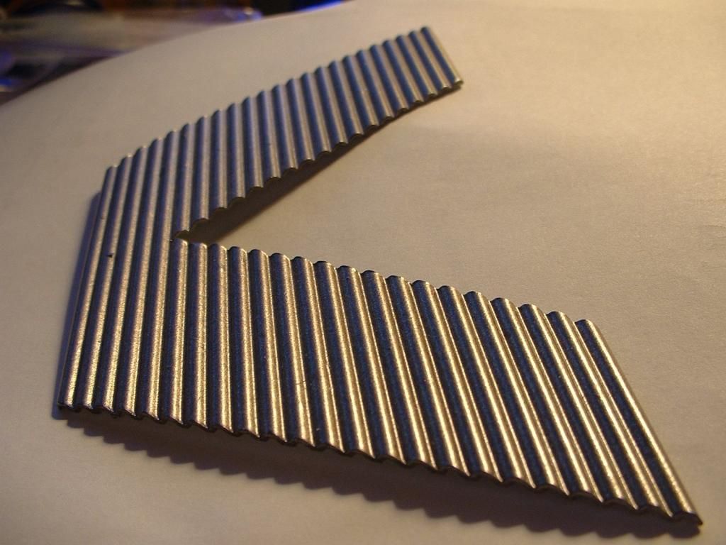

Hello,
I’m working on a project and I’m attempting to locate a particular sheet of plastic. The sheet in question looks like corrugated metal. The material I’m showing has been painted but the plastic is white. The piece pictured is a sample piece a client gave me that he used on a previous project. Sadly he doesn’t recall where he got it or who manufactured it. I can tell you that from valley to valley is .125"
Here is a link to two sample shots.
Sample 1
Sample 2
What I need to know is who sells this material, what the proper name is, and sizing. To me this looks like corrugated metal, but I’m unsure if it’s HO or O scale. Thank you all very much for helping me with this. I figured the experts here would probably know.
EDIT: Sample #2 link repaired.
Evergreen Plastic makes a corrugated sheet with .125" spacing. But from the pics I found in a Google search, the grooves look a bit squarish instead of a smooth sine wave pattern.

I too found that the sheets that Evergreen sold looked like the ribs were too flat. I spoke to my client and he said that he didn’t care if the sheet was flat on one side, but really wanted the ribs to be raised like the sample. I’ll check out Plastruct and see if their sheets are close to. I have found it very irritating that these companies don’t have angle shots of their sheets of styrene for comparison.
To help out, the measurement I gave of .125" was from the center of the valley to the parallel valley.
