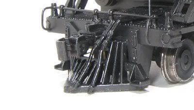

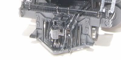

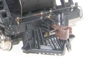

I put a Kadee in the pilot of an IHC 2-6-0 a while ago. Works well. I looked at the Kadee conversion list and the largest IHC steamer listed is a 2-8-2 which is shown as taking a #36 in the pilot. The thirty series Kadee’s have a very tiny round coupler box with a hairspring instead of the bronze spring. The thirty series comes in long, short, and medium length. Each length can be had in center-set, over-set, and under-set. Most of the IHC’s seem to take a centerset coupler. A long coupler always works. I’d try a #36 (long, centerset) and see what happens. If coupler comes out too high or too low, switch to an long under set (31) or long over-set (39) as required.
I had to do considerable Dremel work on the pilot to enlarge the coupler hole in the pilot enough to pass the shank of the coupler. I drilled a mounting hole in the pilot deck and secured the coupler box with a black nylon screw which is nearly invisible against the black plastic pilot. I don’t have much side-to-side motion in the coupler but it is enough for double heading work.
David Starr

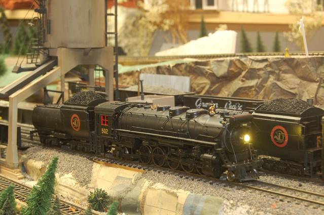

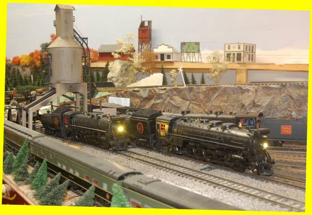

I got three of them as I really like the 2-10-2’s.
Two of them got revamped to look a wee bit more like the CN T4a’s and one is still in the the box to see if I need another 2-10-2 on the Road
Fergie
Here are some photos that show how I installed a coupler in my IHC 2-10-2.

Not sure. The Bachmann Tender is an SP oil tender. I cut a hole in the deck for a speaker and used styrene to build up the Coal Bin Sides. I then took some black foam, shaped it and covered it with Coal trailings. I then wetted it the same way one does ballast and then used a water based clear coat to keep the coal in place. This does not impare the sound what so ever and I will be doing this on several other engines speaker baffle/Fake Coal.
Fergie
