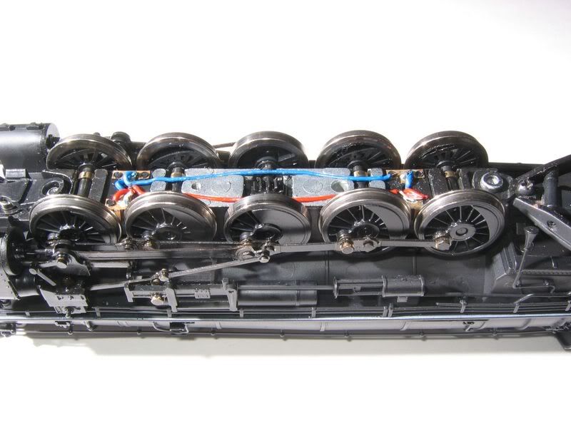

They are very nice but, they don’t have a diecast boiler. It is plastic with a large weight inside. The weight has a large open area near the front (for a smoke generator maybe?) and should be filled with lead to balance out the center of gravity for better pulling.
The frame IS diecast and has 2 of the 5 drivers sprung. The center driver is “blind” (no flanges) as per most prototypes. BUT… It is raised up slightly and does not touch the rails. I believe this is done on purpose so that it doesn’t get hung up on uneven sharp radius track. The other drivers have lots of sideplay and work well even on 18" radius.

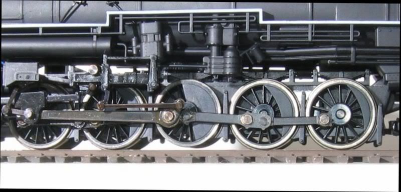

Here is a photo of mine after some alterations…
And here is some closeups of the sprung drivers.
Thanks msowsun for all the photos you are posting. Just waiting for our Extra Foods to get theirs then I will pick up one myself.
Well, don’t necessarily rule the engine out. As our Canadian modeling friends are showing us today, you CAN do some amazing things with the stock model to make it look VERY realistic. True, it takes a bit of time, planning and extra cash, but the results can be worth it.
