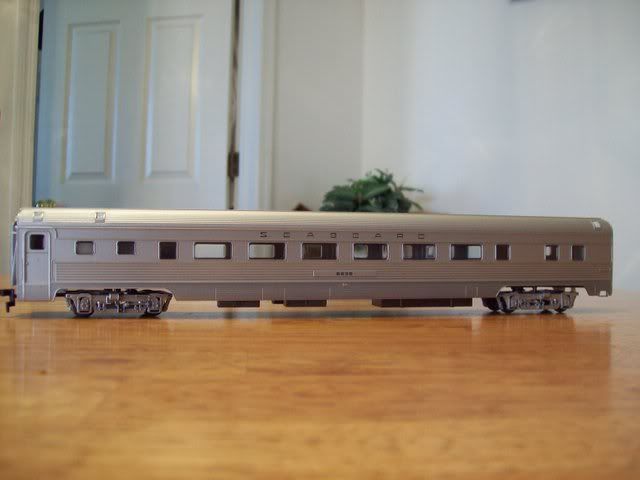

My Rivarossi streamliners were produced during the late 80s-early 90s time period. This is one of them just before I paint stripped it and then metalized it. IMHO, at $16 per car, they were a good buy.
I removed the brake shoes, cut off the skirting, added flat weights, installed 36" wheels, Kadee couplers a painted interior and lightly weathered the underbody. Fixed up they look nice!
