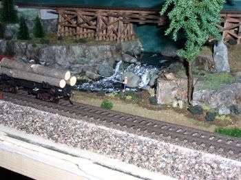

As long as you are using foam in the first place…I have to agree with Art Hill regarding the use of and the carving of just the foam.
At least for my eye, I get the results I’m looking for and I feel it is an easy (though messy with “foam dust” ) and good looking end product method.
I’ll give you that I’m not doing mountains here on the CCRY and that painted foam, looks just like painted foam…The key is to also use your normal layering of ground covers on that paint, just as you would atop plaster and paint.
I have also been successful in carving rock outcroppings then just painting and giving washes to simulate the Greenstone.
As for a plaster on top of foam: I do that too, but very limited with a light weight drywall mud, just enough to blend some edges or seams of the foam.
Hope this helps.
