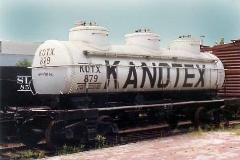

Kanotex is Kansas-Oklahoma-Texas aka Anderson Pritchard Oil Co. of Oklahoma City. Reporting marks KOTX.
KOTX 879 Kanotex was preserved at the Museum of and Transport, in . At least it was before Hurricane Ike. I believe I have a personal photo and will try to scan and upload it. This car was not listed in the 1954 *Register.*KOTX 1004 Kanotex Refining Co ARA spec.III 10,115 gal. blt 1920 &nbs

Here is the Kanotex tank car at Galveston.

Okay.I saw the Kanotex Tank Car at the Galveston RR Museum two years ago.
Hope Ike didn’t damage it too much!!

As far as Kanotex tank car #879 goes, a Mr. Gregory Melle posted a fantastic photo of the actual prototype in Houston on Flickr. The link to the photo is below. It’s obvious the car has been through the ringer. I would suggest it’s been “heavily weathered.”
http://www.flickr.com/photos/canadagood/6231478138/sizes/l/in/photostream/
