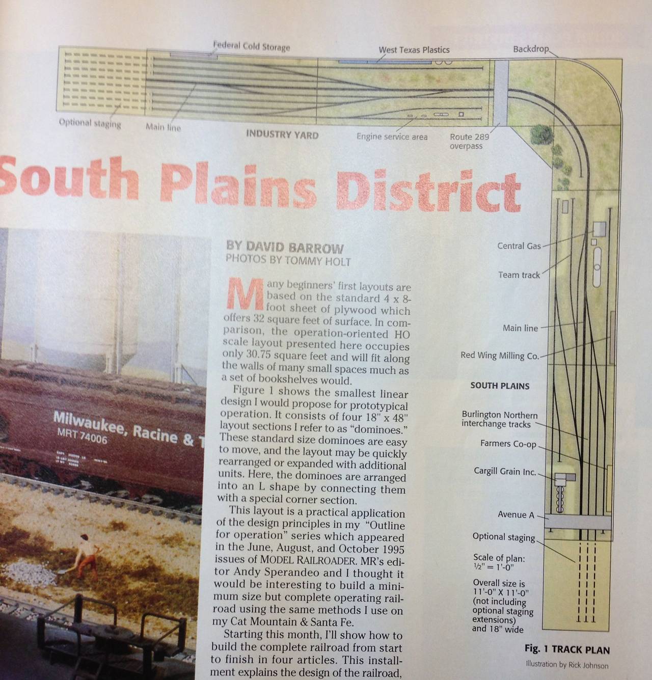

Have you considered a switching layout. Dave barrow built one years ago in less space than a 4x8. was l shape but could be stored away when not in use. and sections have more potential to be reused in a newer larger pike in the future.
