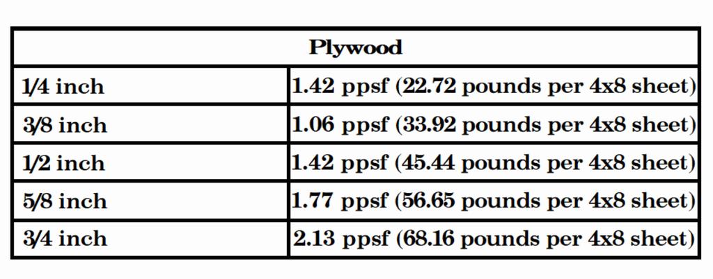

Hello, I’m wanting to create another 4x8 Layout, the first Was started in around 2010 with my grandfather, however I’m wanting to create another one with my Friend Don (or Dad as I should now call him, my mother remarried a few days after Christmas) I’ve been wondering what weight diffrance there is to a 1/2" sheet of ply, a 3/4" sheet of ply or should I go thinner (the problem with the last one was weight and I want this layout to be light as possible, but still durable) and brace the plywood with brich 1x2s a 1/4" sheet of ply and go with foam Layer on top that is 3/4" thick I’m hoping to get started around 5 oclock eastern standard time so any comments before than and after will be warmly recived

About 20 lb difference.

1/4" ply with 2" extruded foam on top - that will be fairly light. See the vatious threads on using adhesive caulk to attach roadbed and track to the foam, since nails won’t work.
1/4" plywood by itself is too thin and will sag. 1/2" is acceptable.
ANother option is to put plywood only where the track will run, and use extruded foam to fill in the open areas to build the scenery on.

Too heavy, there’s a complaint not often seen. I used a variation of this MR plan with 1/2 plywood benchwork, 1/8" luan plywood, either from the Home Depot scrap box or stuff I had on hand and 2" foam.

My first HO scale layout was a 4’x8’ on 1/4" Firply, with 1"x4" framing 16"o/c. Never sagged in the 10 or 12 years I had it, and was in good shape when it was sold.

If weight is an issue, than the easiest way to create a incredibly strong “table” is a 4" thick piece of 4 by 8 ft. Styrofoam insulation board, to which a 1/8" sheet of hardboard is glued on the underside for protection. The sides require also protection.

Lots of options. I use 7/16 (half inch nominal) for flat surfaces like yards sandwiched with Homasote; but for subroadbed that’s on risers, I’m planning on a little thicker with the 5/8’ thickness. I’m not worried about being light weight because my sections aren’t being moved much.
For a 4 by 8 framed layout, 1/2" plywood should be completely fine.
