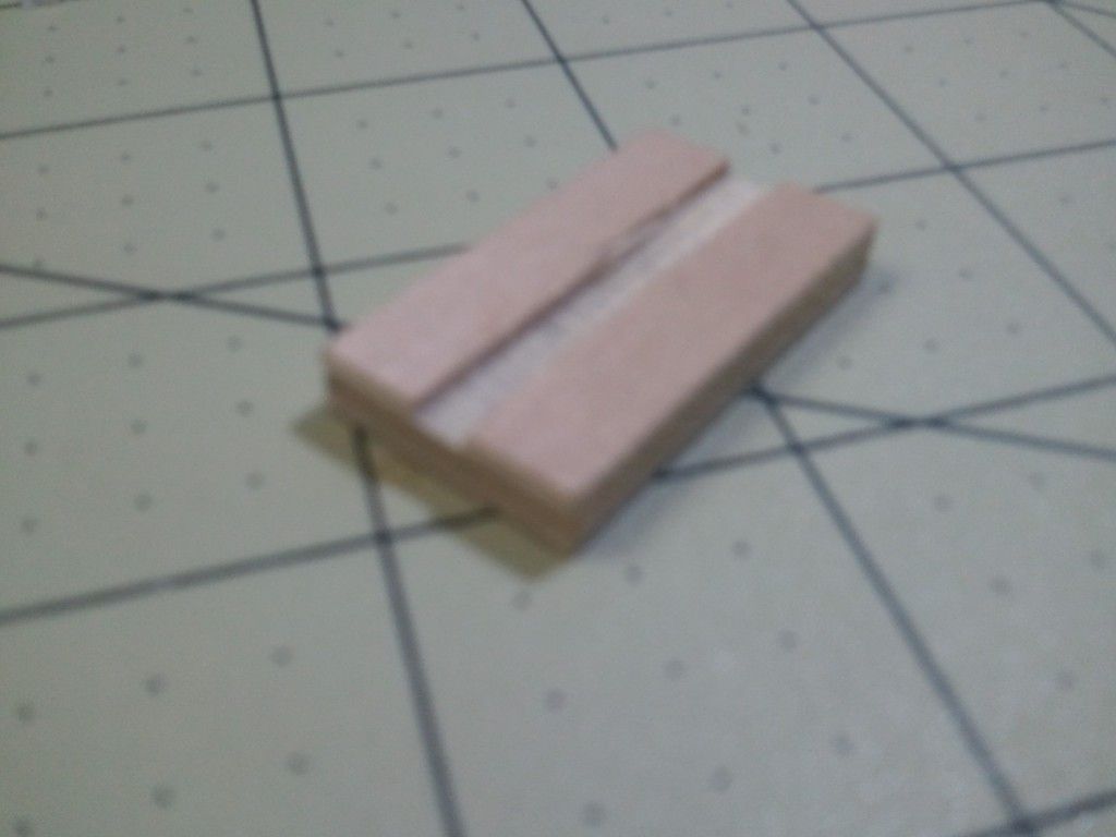

We have run into similar problems on our club layout. Our flex track is mounted on cork roadbed with clear latex caulk, and the cork roadbed is mounted to 2" foam with the same clear caulk. Trying to get a stable mounting for the Caboose Industries switch stands was an issue. One of our members came up with this solution:
He took a handi-panel of 3/16" plywood(same thickness as the cork roadbed) and cut it into 3/4" strips. He then cut a 3/16" wide ‘kerf’ down the center about 1/16" deep. He then cut the strip into 1.5" blocks. We glue the switch stand block next to the throw bar with the same clear acrylic caulk and let it dry. We then attach the switch stand to the turnout and mark where the track nails need to go. We pre-drill the mounting holes and push the track nails home with a needle nose pliers. The result is a good solid mounting base!
