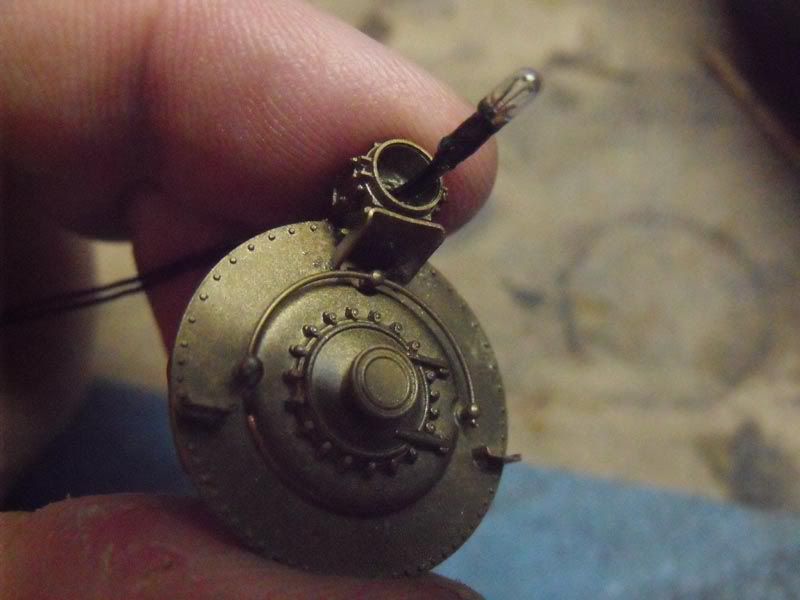

All,
Trying to put a healight in my Brass Decapod. I drilled out the holes to run the wires but am having difficulty finding a bulb small enough to fit. Currently I am using the grain of rice bulbs that Micro Mark sells but even these are too long. I also want to fit some kind of lense or clear piece of plastic to the front. Anyone out there have and experience with this? What would you recommend? Are LEDS smaller than these bulbs? If so, where can I get them? Thanks in advance.

Try searching Walthers for both LED & Incandescent bulbs, I have used small Circuitron & Miniatronics mini bulbs, & some are more than haf a s small as what you have in the picture. Just be sure to get the appropriate resistors &/or a slightly higher value for longer life. If you want I can look at some part numbers I have used in the past. For LED’s Ngineering has a good selection of SMDs that would nest nicely in the buckets. If you shop at Micromark, get the little punch set & using clear sheet you can make lense covers. Or you can fill the whole lens with a water-clear epoxy, but bulb changes are a nightmare.
I think the 2x3mm surface mount LEDS from Ngineering will do nicely. The actual opening in the casting is about 4.5mm. If these are 20ma each do I have to do anything special to hook it up to a standard HO decoder? I will have one for the loco headlight and another for the tender reverse light. These lights won’t be on at the same time.
