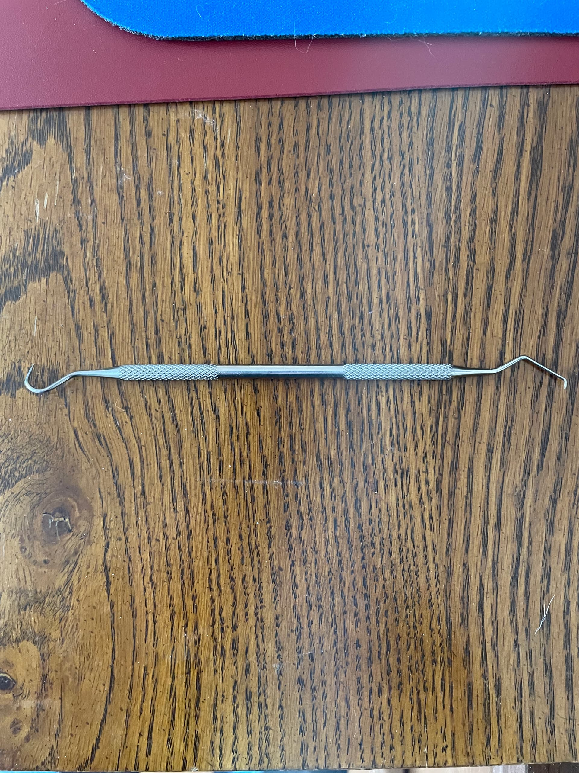

Assemble the motor completely except for the brushes.
Using a fine piece of wire with one end shaped into a hook, lift the brush spring up & to the side, drop the brush in and release the spring. Repeat for the second brush.
