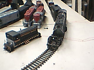

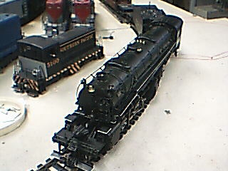

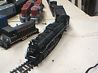

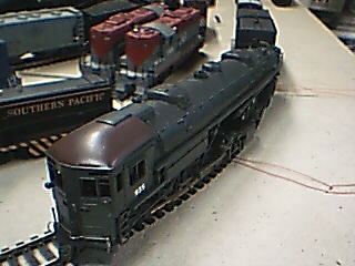

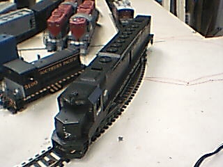

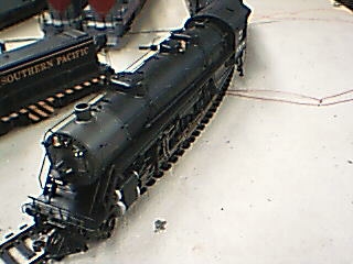

I laid down a loop of 15" radius to test what can/can’t, results are surprising…

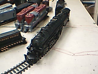

N&W Rivarrossi Y6b 2-8-8-2, loves it

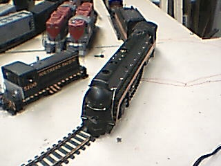

Bachmann early N&W J 4-8-4 with clock drive- loves it, but not the rough track portion.

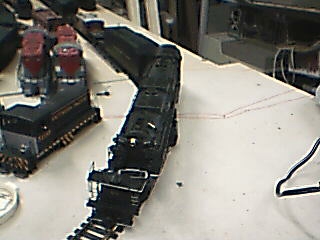

Rivarrossi 4-8-8-2 cab forward…iffy, doesn’t like the rough track sectionmakes thru some of the curves.

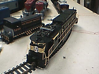

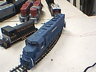

Older Athearn SD9, 6 wheel trucks, OK, wobbly on the curves tho
Older athearn DD40 2 motors, Talgo trucks-yup, but no likey rough track section.
LL NKP 765 first run-tight but no
BLI N&W 2-6-6-4 - no

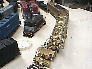

Akane DM&IR 2-8-8-4 - OMG it got into the curve! The centipede tender balks at it tho, a little more side play on the wheels it might make it. It just might like 18 inch radius tho.

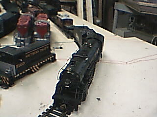

Bachmann 2-10-2 - no - front drivers off in this pic.
Bachmann W&LE 2-6-6-2 - YES - iffy on the rough track tho
Bachmann 4-8-2 - YES -
Brass NKP South Shore 700 - YES

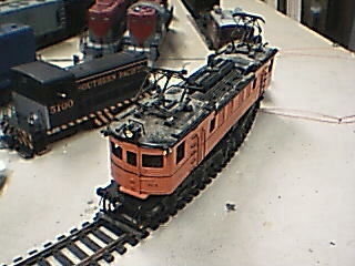

Bachmann E33 - no
Rivarossi 2-6-6-6 first run - YES - they did it again…doesnt like the rough track
I’d sure like to see some more pics of that Akane 2-8-8-4! (just not on 15" curves![:P])

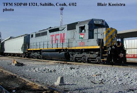

This is an SDP40, not an SD9.

Rivarrossi’s locos could all handle 18" radius, by design. Both front and rear drivers pivot. Plus there is enought lateral sloppiness in the drivers that lets it do this. The 2-8-8-4 however is prototypically designed, rigid rear drivers and front pivot. Because of this I was surprised the 2-8-8-4 made it into the 15" curve, huge overhang. Kudos to Akane and their design, it almost could do it.

Except there’s a BIG difference between a SD9 and a SDP40. They look nothing similar. it should take a spotter’s guide to know that there’s a difference between them. Typically when then were minor changes in a design they have been referred to as phases such as Phase I, Pahse II etc. not new model designations.

SD9
SDP40
I yam corrected

Holy cow, that Yellowstone on a 15"? Almost dropped my glasses when I saw the photo, LOL! I KNOW Akane built a lot of lateral motion into the loco and tender to enable it to take about a minimum 24" radius, but you’ve really pressed her, my friend. But at least you know that if you decide on 24" minimum, you’ll have a brass articulated that can do it. However, if you haven’t done it yet, I’d really suggest putting in a NWSL universal joint between the 1st and 2nd set of drivers. The rubber tubing that Akane uses can cause enough lateral stress around curves to burn out the motor. Found that out with my first one.
But boy, I NEVER figured the Yellowstone for THAT small a radius, LOL!
Tom [:)]
Neither did I. It almost could, tho I don’t reccomend it. I just ran it into the curve to see what, boy I was surprised.
I have been running it on 22" radius loop from time to time to break it in sporadically as its mechanics are tight. Its technichally a brand new engine as it sat in a hobbyshop virtually untouched. I’m guessing the motor magnet could be weakened. But its running like a champ for now. I have the NWSL linkage laying around and I want to change the motor to a NWSL. I will prolly take it apart in the future and re-go over the mechanics, make the changes then it’ll be a ripping engine.
