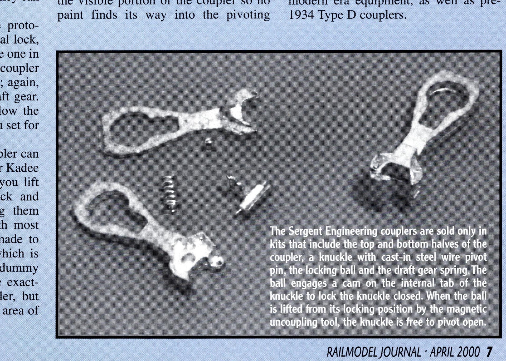

For this reason, I believe there is much value in the existence of couplers other than the Kadee style. When Sergeant was introduced in the April 2000 issue of RMJ magazine, I thought it would be difficult for it to become popular because of its soft metal material, but when I read in the June 2005 issue of RMC magazine that it had been made into a diecast model, I thought it would likely sell.
Page 7 of the April 2000 issue of RMJ magazine

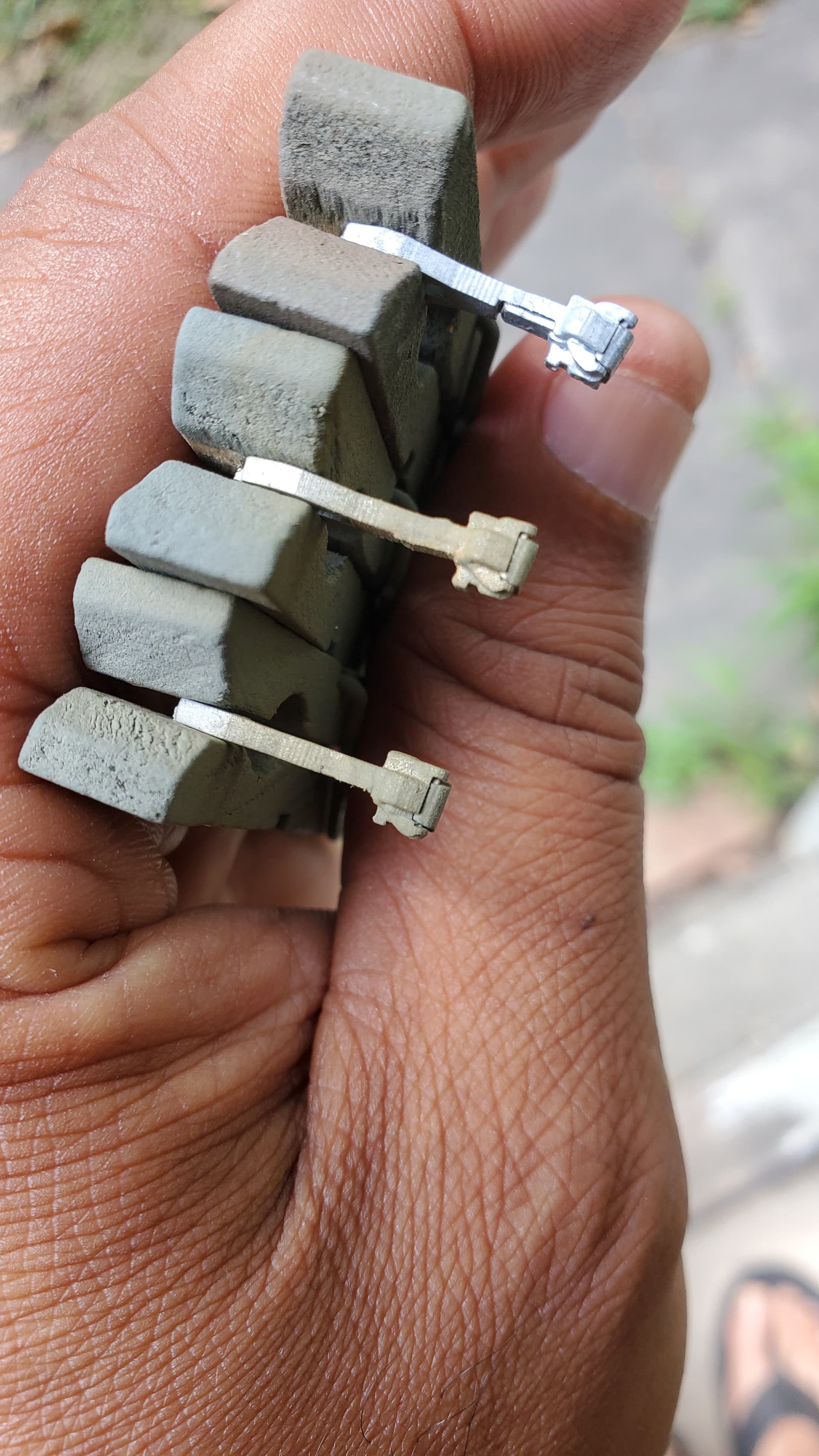

The photo attached is of 3 long shank Type E variants from Prototype Couplers. The first (top) coupler is assembled and ready to use, so to speak. The second (middle) coupler has a layer of self-etching automotive metal primer and a dusting of Tamiya orange with a hint of brown acrylic diluted with 70% IPA and applied with an airbrush. Lastly, the bottom one has a lighter dusting of the same middle paint applied to it.
As long as you do not over apply paint, you should not have problems with the overall function of the coupler. There are cases in which some have pre-painted the couplers before assembly. I, however, have a “strict process” for assembly of these types of couplers and painting after they are assembled is a safer bet to no have issues later. -cf
