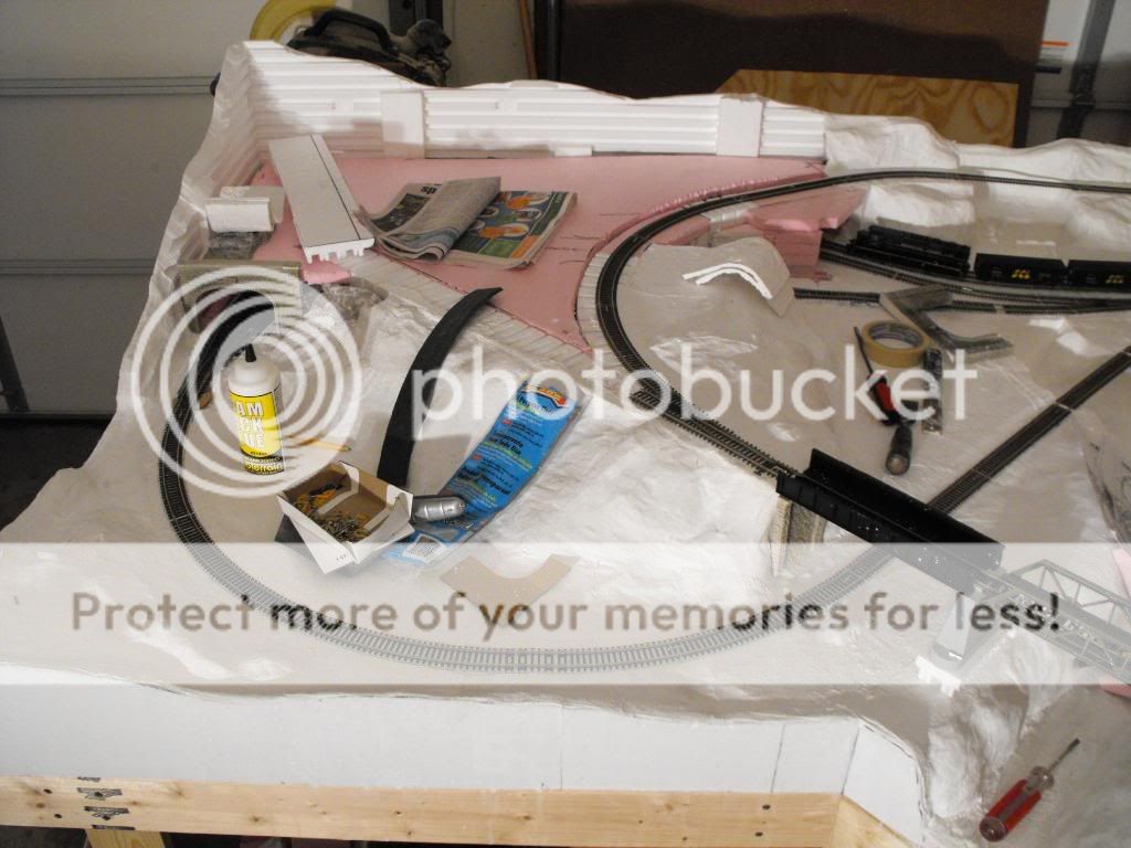

OK…here are the pix, as previously promised…
OVERALL TRACK PLAN (Rancocas Harbour Belt from the Atlas King Size Layout book)…
BIRD’S EYE VIEW OF THE REAL LAYOUT…
THE RIVER… (OR GORGE, I’M AFRAID, DUE TO SCALE DEPTH!)…
TUNNEL IN BACK, RIGHT CORNER…
TUNNEL PORTALS/RETAINING WALLS TEMPORARILY IN PLACE…
CLOSE UP VIEW OF RIVER & WATERFALL. THE WATER WILL COME UNDER THE BRIDGE FROM OFF THE LAYOUT, GO OVER THE WATERFALL, UNDER 2 TRACKS THAT I WILL BUILD TO APPEAR LIKE A BRIDGE, BUT IT WILL BE FAKE, THEN UNDER A REAL BRIDGE, CONTINUING TO THE FRONT OF THE LAYOUT…
OK, guys (and girls), let the creative juices flow and suggest away. In the "bird’s eye view pic, you’ll see a flat pc of pink foam towards the right, center. That was where I had planned on putting my town, but after seeing teh room I have in real life, there’s no way to put a row of shops, a street, sidewalks, etc. in that area. I have the other side of that track (to the

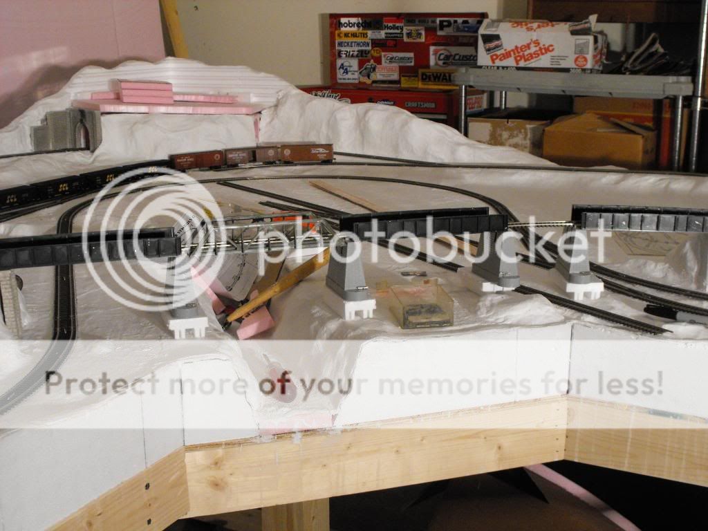

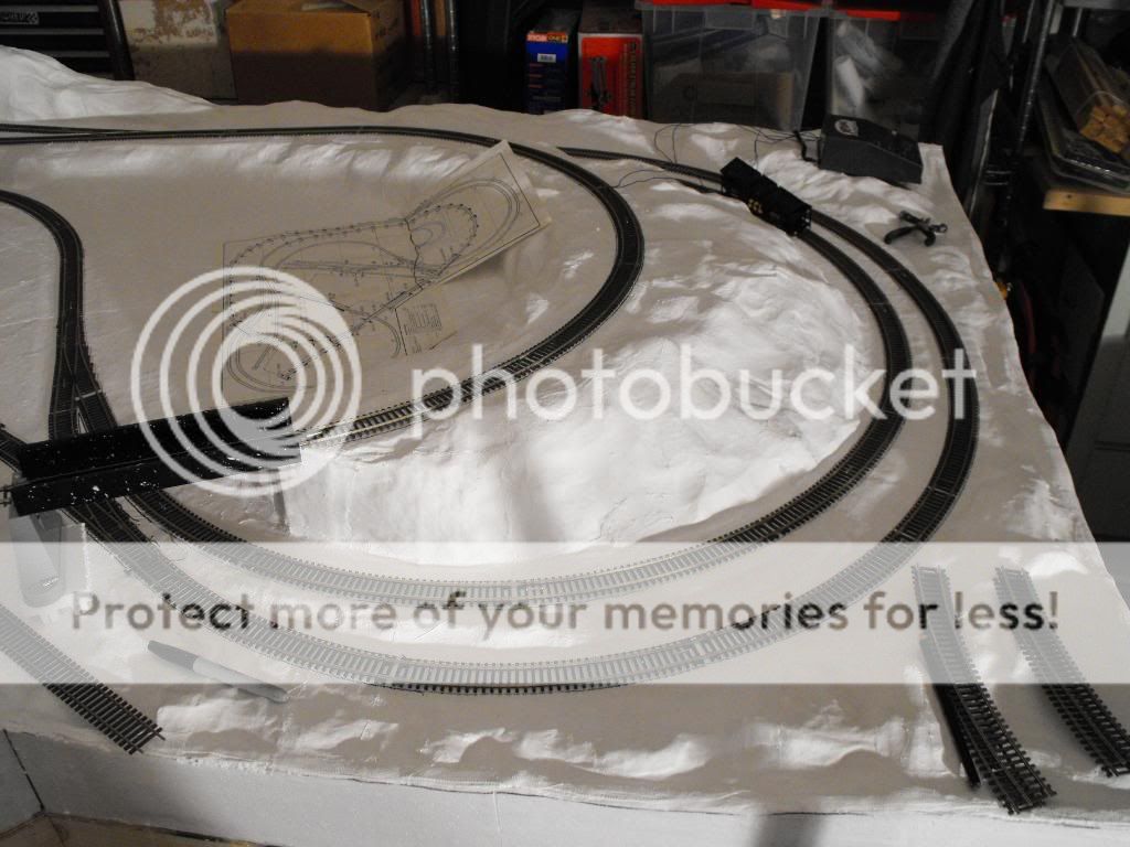

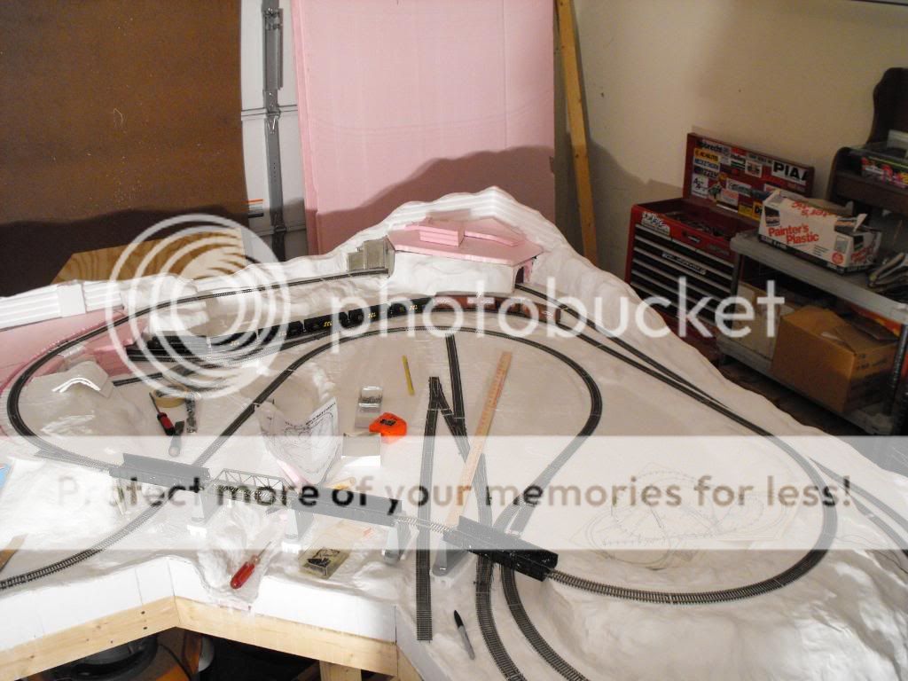

OK, here is the update, but don’t get too excited. Haven’t done anything in about a week and a half. But, at least the track is down enough for me to run the trains for a while. I’ve marked the tracks and will be pulling it back up, laying roadbed, then laying the track for good…can’t wait!
Overall shot…

Still deciding on what to do with these bridges…
Where the town and passenger terminal will be going…
