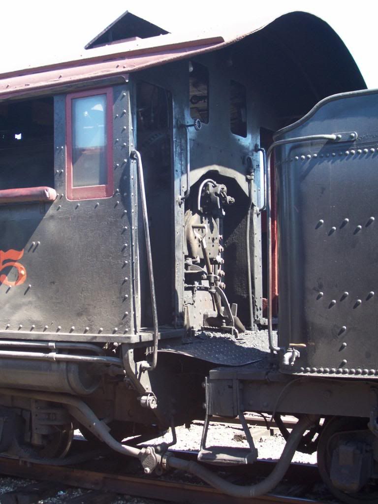

Yup, this is narrow gauge, but the fireman stands on the cab apron to work. I’d guess that this old girl has a really huge can motor powering her:
Pretty cheap to detail, too. [swg]
[:D][Y][:o)]
Great point, Doc. Check your prototype. That backhead sticking out of the back of the cab might just be correct. In fact, manufacturers have been known to choose such prototypes on purpose because the rivet counters can’t find traction[8o|]
Same thing with boiler diameter. In the “good” ol’ days of big honking motors, there were two ways to deal with that issue. Choose a prototype with a fat boiler. Or make the boiler just a little more “generous” than it was in real life.
Again, if something doesn’t look right, it might not be. Then it again, it might just be the way the prototype did it.
