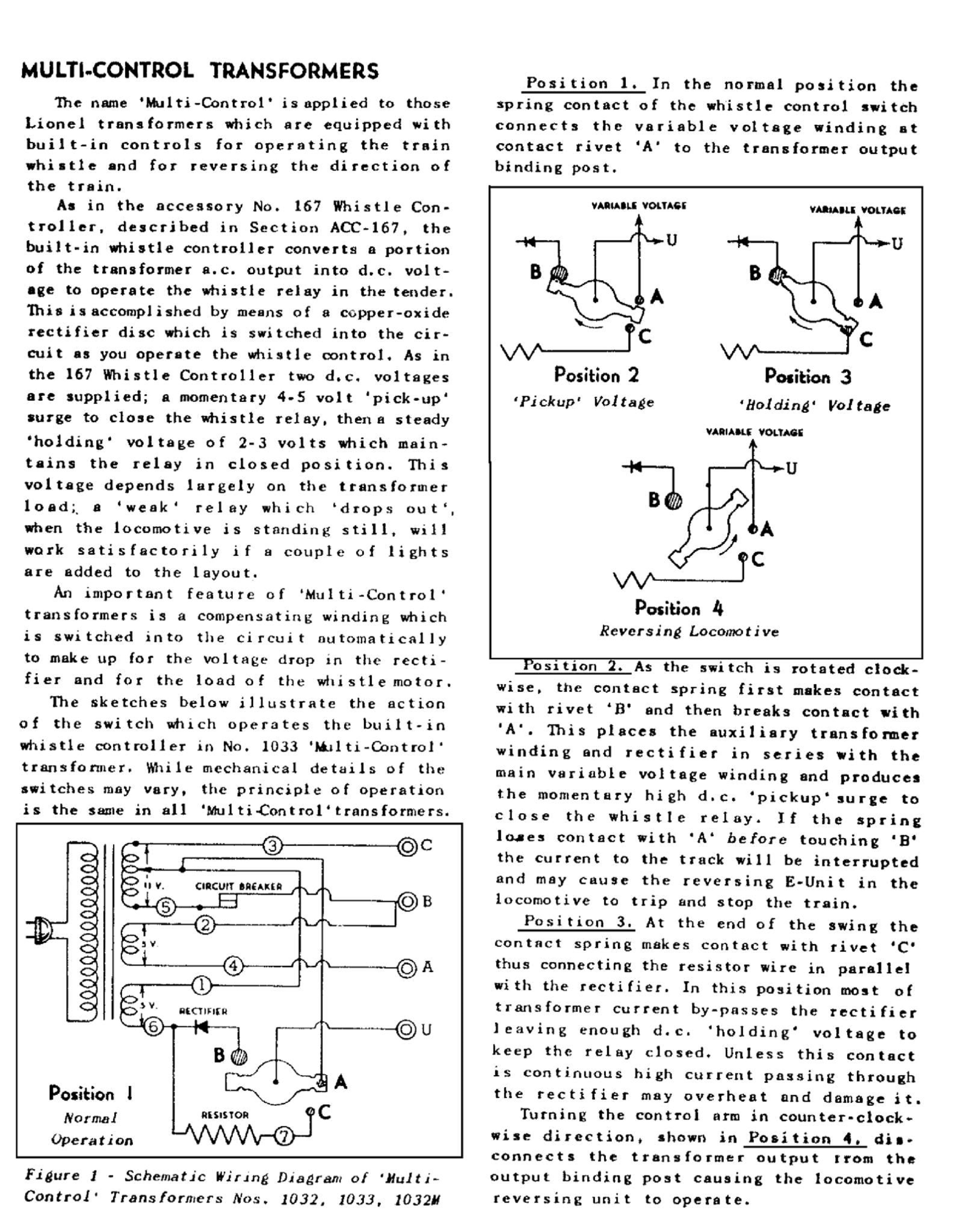

If you study the schematics and the Lionel whistle operation theory, you will see that there must be a load on the circuit beyond that of just a standing/idle piece of equipment to draw enough current through the rectifier to reach the “hold” threshold voltage of the DC component imposed on the AC.
