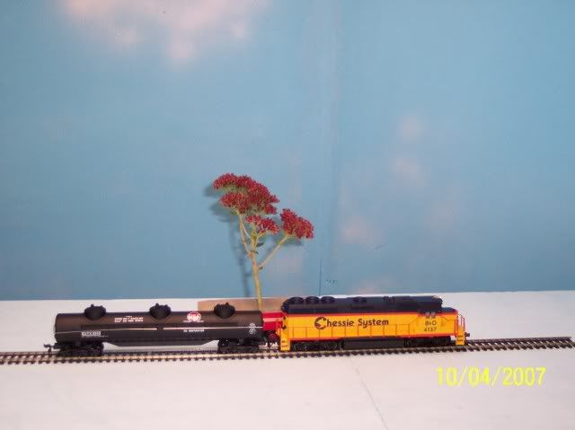

While doing yard work (outside) I saw a group of sedums and thought they might be potential tree material. This is a fresh cutting so when it dries out it would have to be colored. And of course the height is easily adjusted. Your opinions will be appreciated. Please excuse the background. As you can tell I’m just getting started but want to gather these plants while I can if worth while.
Thanks, Bob
I would suggest a closer picture of the item in question so the branching and structure of the plant could be seen. From the distance in the picture, it is difficult to make the call.
Don Z.
I spotted a sedum in the garden last week, and immediately laid claim to it. My wife gave me advice on drying it. Yes, those should make great trees. The same wife was about to toss some baby’s breath that had appeared in a bouquet to my daughter from her boyfriend a couple of weeks ago. The flowers had reached their limit, but once again, I grabbed the baby’s breath for trees.
I harvested a grocery bag full of those “armatures”, although they did not have the red florets…what we have up here is just a bland yellow…but I think if you clip off the florets you will have the basis for an excellent tree. Just spray tacky glue or whatever, dust with course foam or that Silfor stuff (I forget), and then spray some hair-hold over that. Joe Fugate would suggest a very light sprinkling of yellow foam or a light spritz of yellow paint to simulate sunny hilites.
I use those for most of my trees. When they’re dried, the leaves turn brown, and if you’re careful, they last without a spray; some of my trees are 3 or 4 year old now.
Here’s a photo of them.
It’s the tree in the lower left corner, there’s several more trees of that type in the photo that are more in focus though.
By far, the best looking trees I’ve ever seen are the SuperSage trees from Scenic Express. They had some on display at the National Train Show in Detroit. Amazing. Their Super Trees are pretty amazing, but the trunks and main branches were always to thin. The combination of the two plants solves that issue.
Unfortunately, they charge $110 for enough material to make ~45 Supersage trees while they charge the same amount for enough Super Tree material to make 300 to 400 trees. You could use the sedum you’ve found as armatures and add the Scenic Express Super Trees material for the fine branch structure and get pretty much the same thing.
If you have sedum growing in your area, cut the stems while the foliage is still blooming. Tie it in bunches using rubber bands and hang upside down in a garage for about a month to dry. The sedum bloom is fairly hardy once dried and can easily take a coating of hair spray or white glue if you want to change colors. Another similar plant is yarrow, which can commonly be found at very reasonable prices at places like Michael’s in the dried flower section. You could many hundreds of trees from sedum or yarrow for less than $50. For those of you in the south, don’t toss away the spent blooms from crepe myrtles either. Their structure is an almost perfect tree aramature if you use the blooms that grew straight out from the tips of branches.
Men, Thanks a lot for your replies and ideas. I’ll begin harvesting this weekend. They will have plenty of time to dry because of the time it will take before I’m ready to landscape. One of the first bits of advice I got from the forum was to have patience. Boy, have I learned that was true. Also, Jim we have a nice crape myrtle bush in the back yard just waiting for the clippers.
