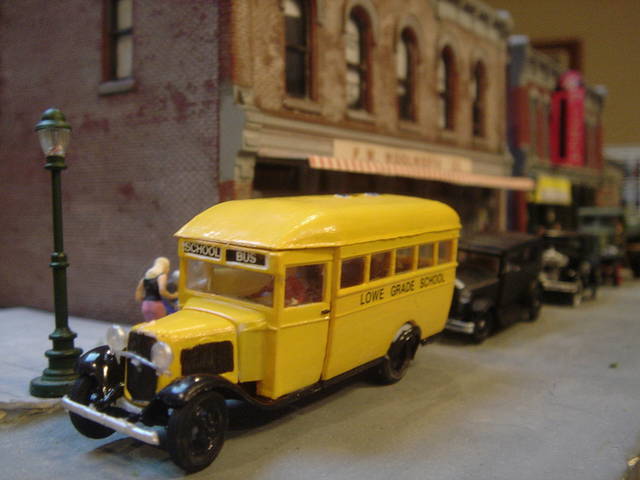

I built my Jordan bus as a school bus also with driver and children. Muscongus was a town on one of my previous layouts, and will be re-appearing on my present one. Muscongus is an actual town name on the Maine coast, now part of Bremen. Also shown is the Jordan 1926 Essex sedan.
