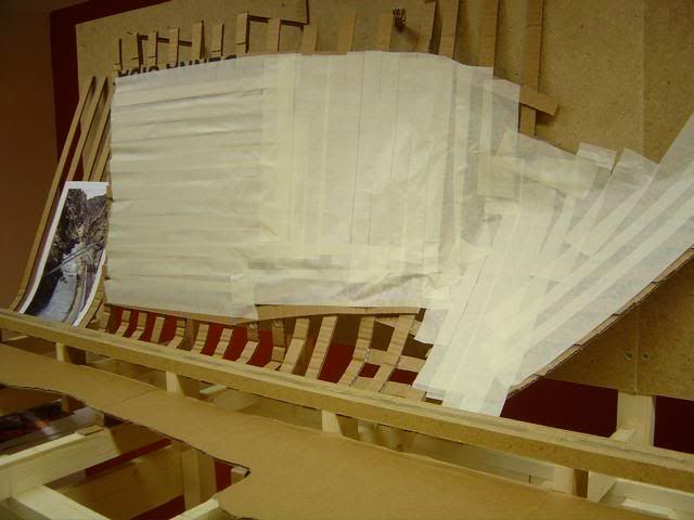

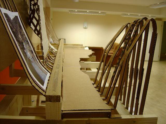

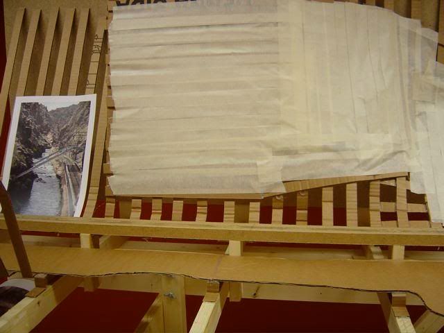

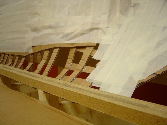

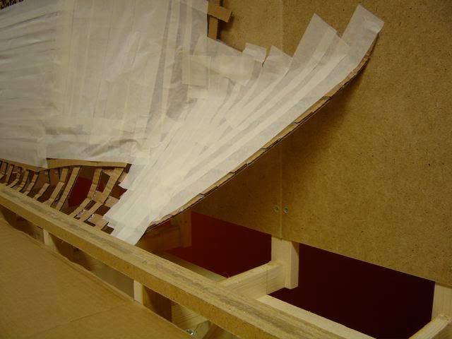

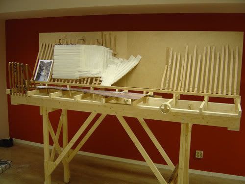

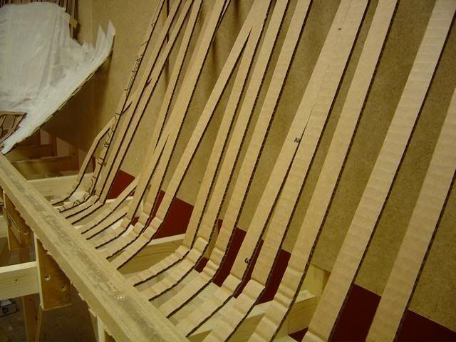

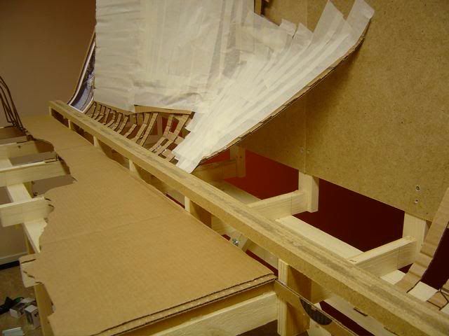

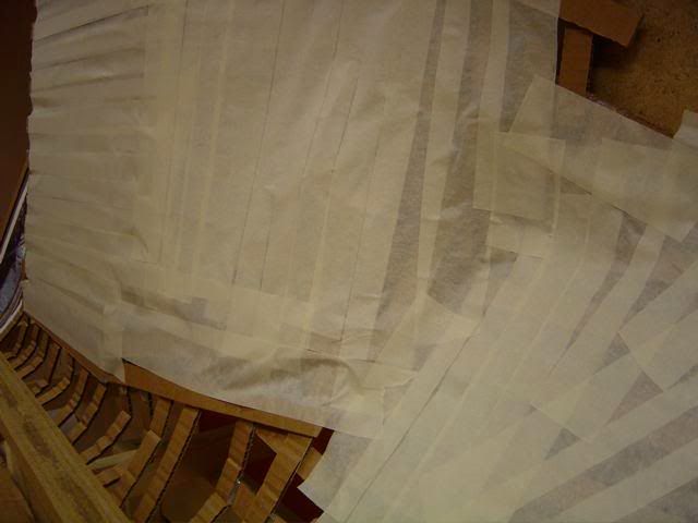

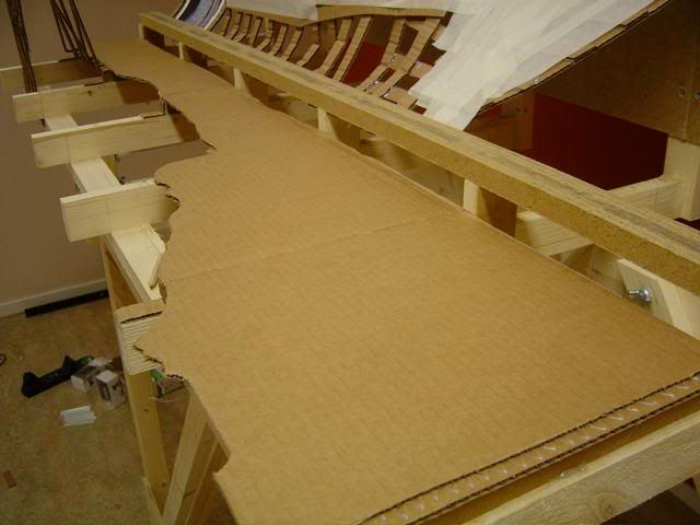

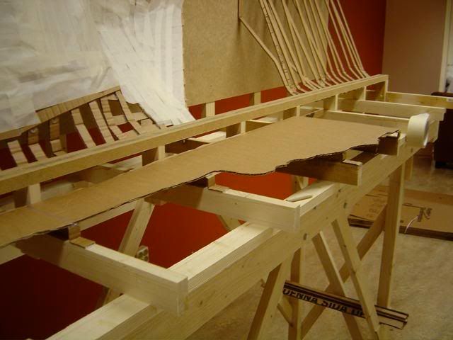

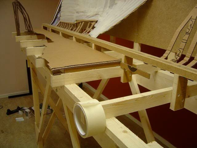

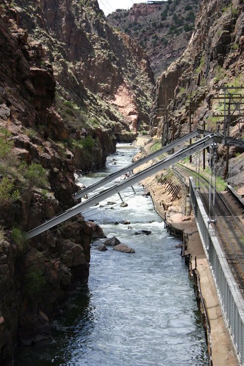

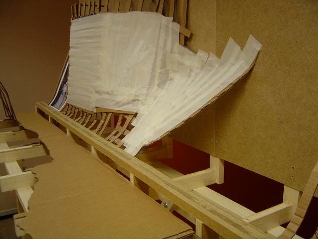

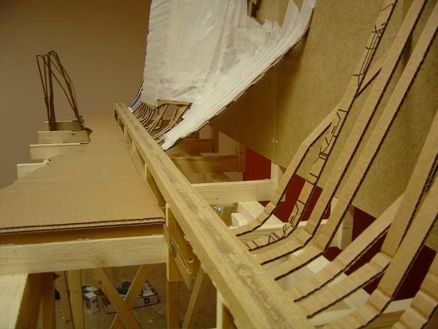

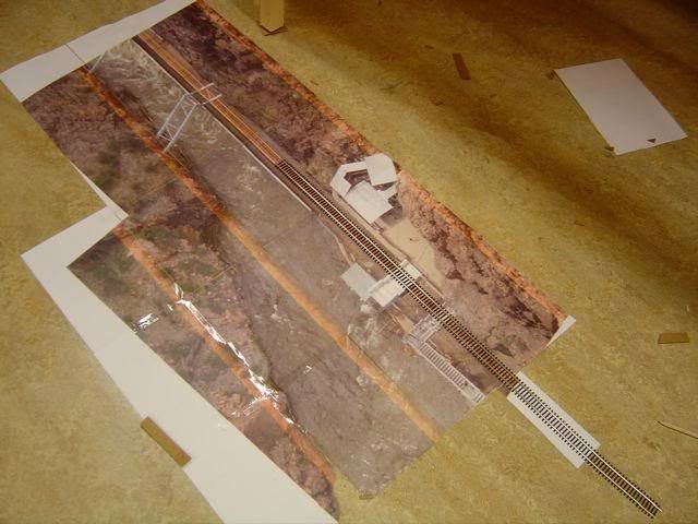

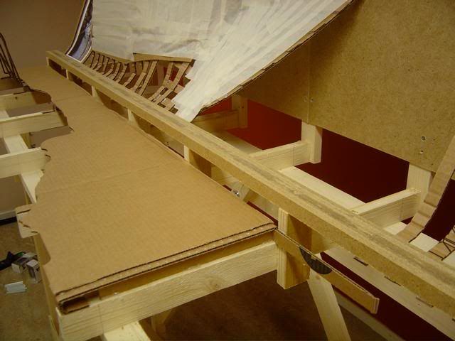

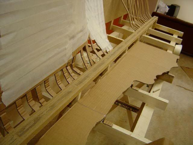

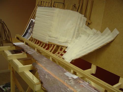

Just want to show my latest work. It takes some time to do but it’s very fun. My plan is to cover everything with cardboard strips, masking tape, Joe Fugate’s vermiculite mix and rock molds from Bragdon Enterprises. The water will probably be envirotex. The hanging bridge will be located to the left. As you can see I printed out a BIG paper with a color laser to make it easier to place things. It works great and I can really recommend it if you want to build your model close to the prototype. I will model rocks on both sides of the bridge (as in the prototype). That will force the viewer to look at the bridge from a certain direction. Look at the last of these 5 photos, that is the direction from where you can see the bridge when the rocks are in place.
That is very impressive, Electro. You are very clearly being methodical and careful. The results should be spectacular.

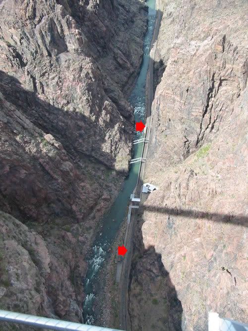

Here is a better photo, my module is between the red arrows.
Aahh, now that makes sense. Thanks for clearing that up for me. You sure have your work cut out for you!

Quite a challenging prototype to model. It is really some unique bridge and I am impressed with what you have done so far. I would mention that the dark colored tall cardboard may need some additional support at the edge of the benchwork. Hate to see it get hit and damage all the rock work.

I will use 1/4 inch plywood at both ends of the module. I will also build a fascia so all rock work will be protected from damage.
Thanks guys for the very nice comments. I’m really honored to be compared to guys like Pelle Soeberg. I really hope I can live up to that in the end. The hardest bit for me is to get all dimensions of the prototype. I have several hundred pictures of the hanging bridge and the surroundings. Without these pictures I could not build this. I want to thank the owners of the pictures. You know who you are. They are all gentlemen that help other model railroaders without wanting anything in return. All styrene for the bridge is ordered and will arrive within 10 days.
