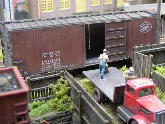

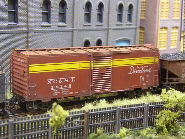

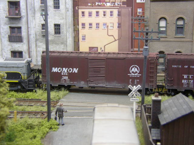

There is of course a matter of personal preference here - I find that the Intermountain sets have a slightly finer profile and don’t like some of my sharp curves (or indifferent track laying[:P]); whereas Kadees run fine, as do Proto. I therefore have replaced several Intermountain sets for Kadees.
Again I personally don’t like my freight cars to be too free rolling (I like them to stay where they are spotted if the siding is fairly level - not roll away on even the slightest grade) and as a result the Kadee trucks suit me just fine too. Again I’ve replaced some of the smoother rigid cast delrin trucks with sprung metal Kadee ones.
The thing about Kadee cars is that they are right up there in the detail quality department with Intermountain and Red Caboose.
Kadee boxcars are my own personal favourite and the friction in the axle bearings is a plus for me, not a criticism.
I don’t like my freight cars to be too free-rolling, as they are normally run on a switching layout in short trains and switched out often. Having a bit of friction in the wheels stops them running away too freely.
To date, all of the doors open although some are a bit stiff
Jon
