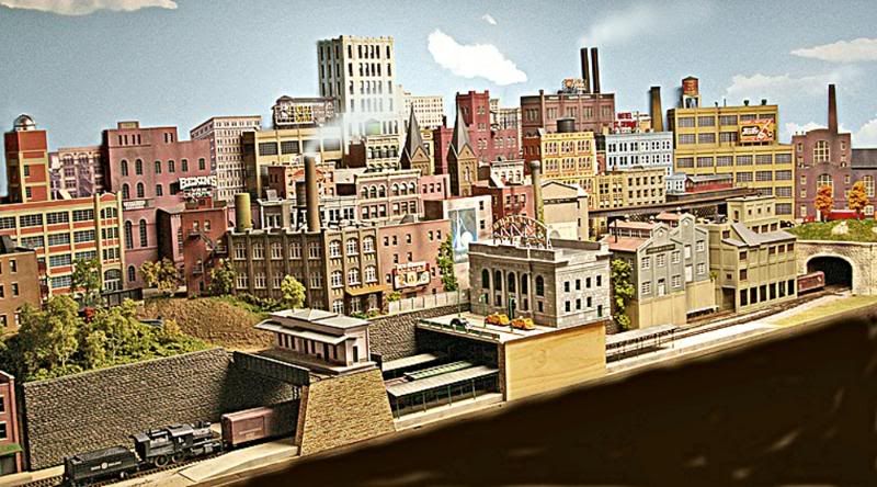

I guess my modeling technique goes against the general flow of opinions here, but for decades I have assembled virtually all my structures prior to painting them and get results that I feel are pretty much second to none.
In my experience, pre-painting wall sections often leads to paint being deposited on the edges to be bonded and unless all these edges are at least lightly sanded after painting, poor bonding of the parts often results. Neither do I find any difficulty in painting windows and three-dimensional details on any completed buildings if the walls and windows are one (I always brush paint them) and often wonder why others infer that they do. Likewise, since the model is painted as a solid unit, I think I get a better uniformity of color/texture overall, plus I can weather them at the same time.
In the image below, all the structures seen were built first, then painted for detail and the process probably even went somewhat faster than if I had approached the job in reverse. If nothing else, it shows that either approach can work satisfactorily.
