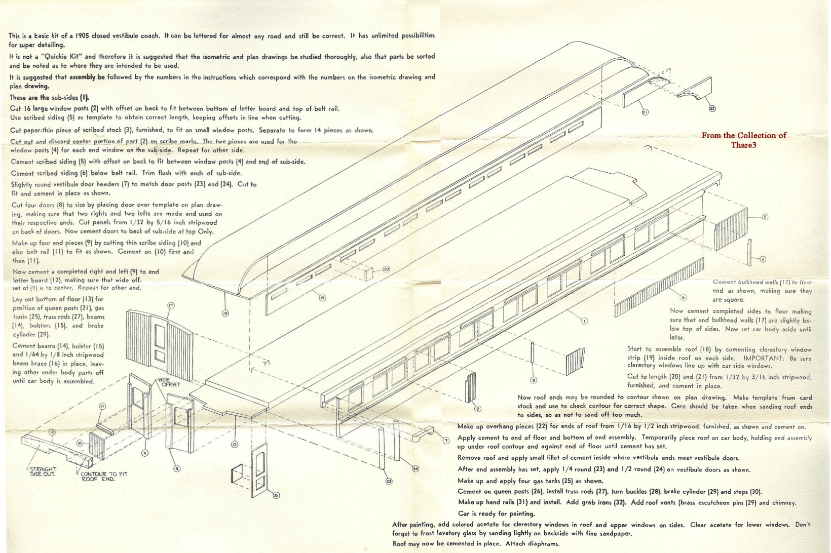

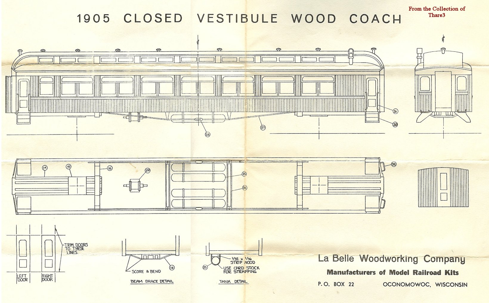

But it might help you decide if you look at some typical directions. I don’t know which kits you are thinking about, but the HOSeeker website has some of the directions available for you to view. Here are links to two instruction pages for a 1905 coach:
http://www.hoseeker.org/labelle/labelle1905coachcarpg1.jpg
http://www.hoseeker.org/labelle/labelle1905coachcarpg2.jpg
I’m pretty sure that LaBelle still produces, so it’s possible that the kits have become easier. But they probably will still be challenging to a first-timer.

I just went to the LaBelle website, so they must still be producing. They’ve got the directions for the kits online, so you can check out the assembly method.
