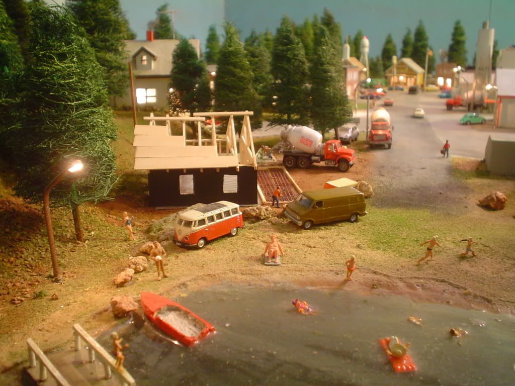

Morning eaglebeak, I thought I might be able to help you here. When I made my beach, I used some play sand and sifted it through an old clothes dryer filter (The one that is fine screen wire) and put the sand along the lake shore and used Elmers glue/water mixture to hold it in place then after that was dry, I used WS realistic water for the lake. I did the lake in probley 8 or 10 different pours. Here is a pic that may help, let me know if I can do more. Mike

Nice scene [:D] Isn’t it just typical? You chill on the beach and someone goes and backs up a truck to start pouring concrete [|(]
What I’m really interested in is what you did to position the swimmers in the water please?
You’ve said that you poured in several layers, which is the best way to do it in my experience… BUT… once you’d got to the point of putting the figures in…did you fit them and then pour or pour round them and support them somehow?
TIA
[8D]
Sure, all I did was when I poured the second layer or so, while the ‘‘water’’ was stil wet, I placed the figures in the water and when the water was dried, the figures were there. As I poured the remainder of the water, it just sort of flowed around the little folks. I did a concrete swimming pool on the other half of the layout, and used the same process to put in the swimmers. I really felt sorry for the swimmers this past winter, I bet that water got pretty cold!!. Mike
