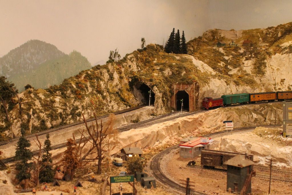

Good question about the type of trees. I have not got a clue. The new scene will be in Northern New Mexico but the mountain is a take off of Mt Hood Oregon. As my layout is not a winter layout I picked Mt Hood as they ski all year. The new mountain will now go where the picture of the red mountain was until the afternoon when it was removed. The bottom half will be the trees and the top half will be above tree line with a lodge and ski lift going another third up. The mountain will extend up to the curve you see at the top.
The mountain will cover the two upper tracks to form a tunnel. My Layout is HO but I am thinking of doing the scene in N scale to create a forced prosective. I did this with the building you see on the other mountain. Any ideas are greatly welcome.

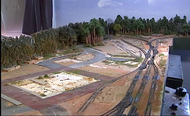

I “rolled my own” from wire and twine as descfribed by “cowman” above, for my old East Texas piney woods layout. My results:
and during dismantling…
