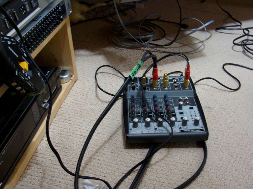

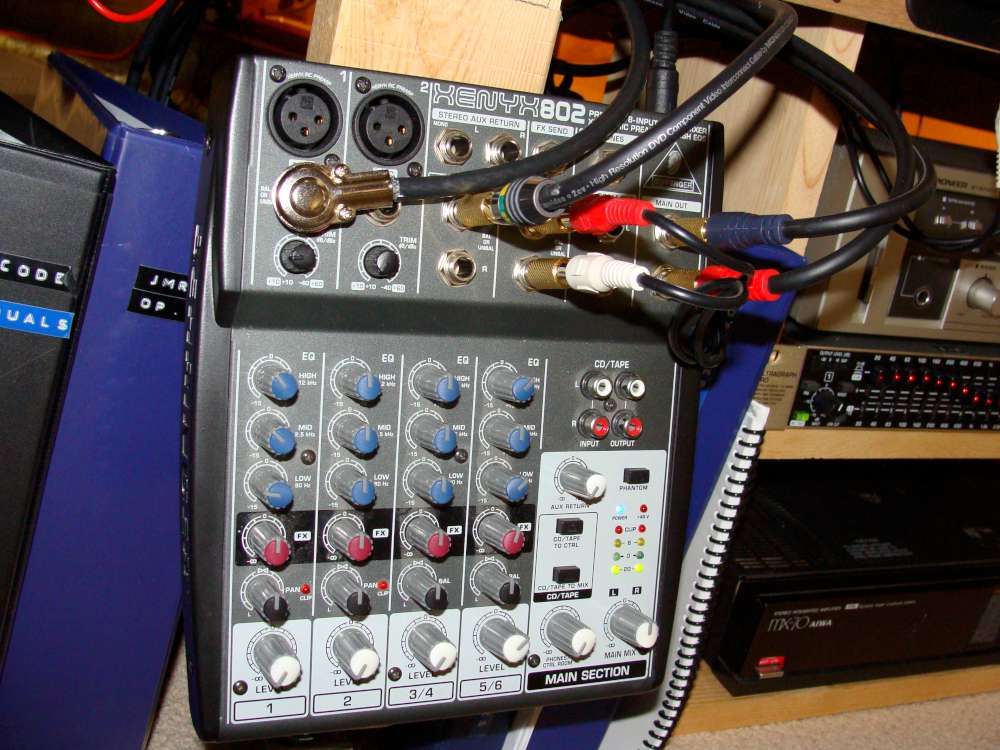

Finally, after adding several sound sources/sound scapes I hit on the perfect mixing board. This is a Xenyx 802 mixer made by Behringer of Germany (tho the unit probably made in Asia) same brand as the equalizer shown below.
It has up to 8 possible inputs, either balanced or unbalanced, but most importantly it costs just $50 used (like mine from Craigslist) or about $75 new. These units are amazing for the price, compared to what I used to have to pay ordering mixing equipment for the high schools.

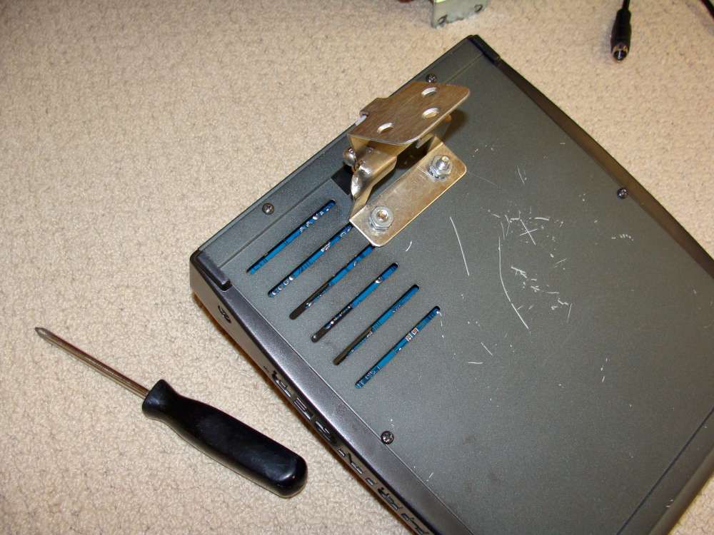

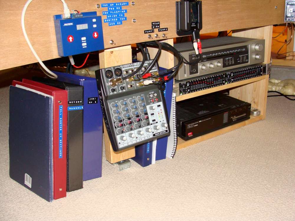

Just add a cupboard door hinge on the back for an angled bracket to hold it near my sound equipment below the layout fascia…
and there you have it. Plug the lines in and mix away.
Because the unit also provides a small three band equalizer for 6 of the inputs, I can tweak up the sources not already sent through the main equalizer.

I play it on a Panasonic MP3 player I picked up for $30…just jacked in stereo inputs to the board you see. One of the shots has the player, I think, showing in its throttle holder I put on the fascia. With stereo, of course, I can pan effects like locos and vehicles in the background track from side to side. Makes a great thunderstorm effect passing over too, plus overhead jets and prop planes occasionally.
