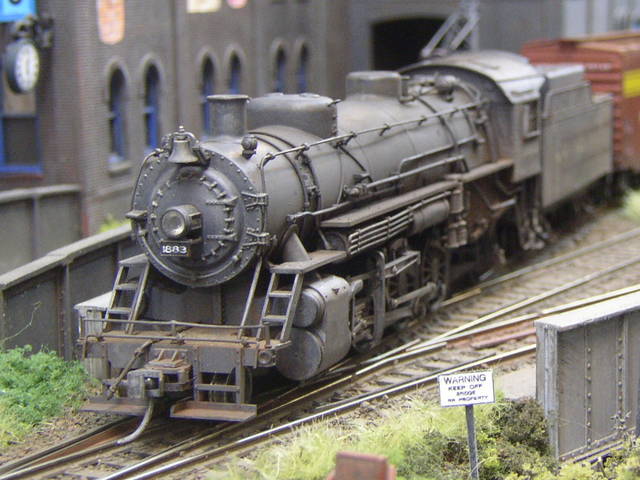

Latest project - a Trix NYC Mikado
I picked up this beauty recently in part exchange for some outgoing Athearn BB locos. If I sat down and worked it out, it probably cost me in excess of 20 BB locos[:-bigeyes][B)] - worth it too.
My first task was to soundchip it - I borrowed a Tsunami medium decoder from another loco and semi-hard wired it by soldering the leads to the NMRA 8-pin plug in the tender. After covering up any holes in the tender with electricians’ tape it sounds awesome.
Next I removed the non-working front coupler and replaced it with a 30-series Kadee - the small coupler box allows plenty of swing for the pilot wheels on the front truck.

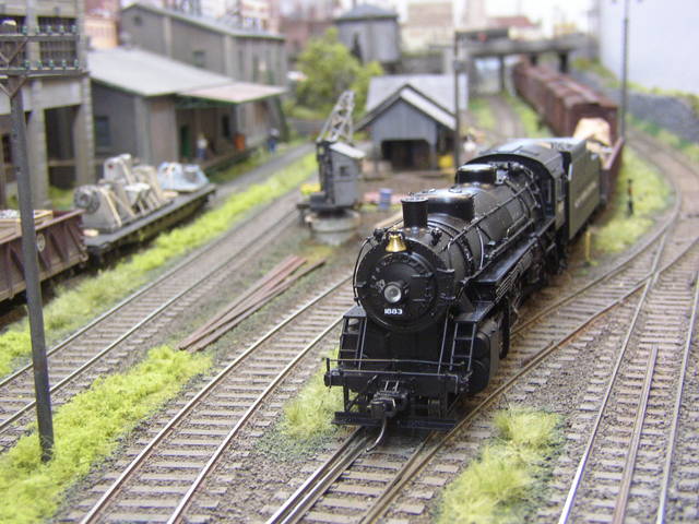

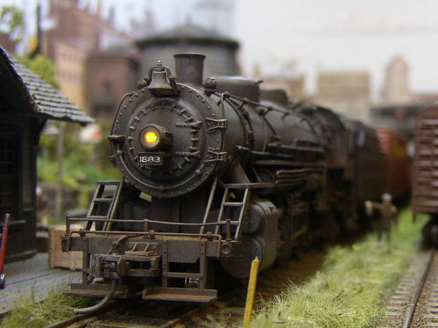

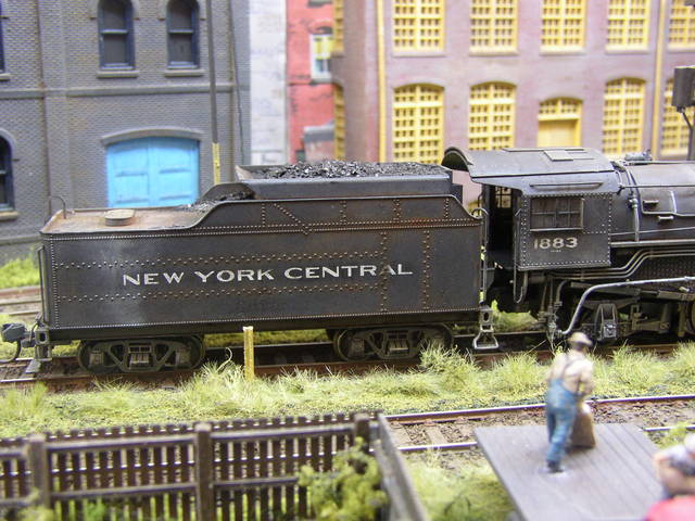

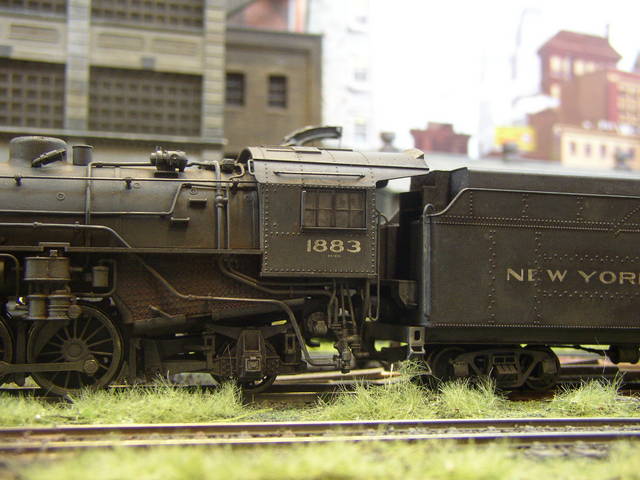

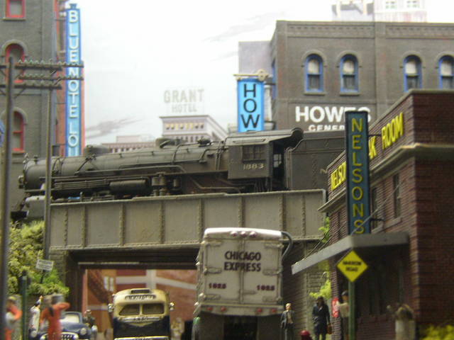

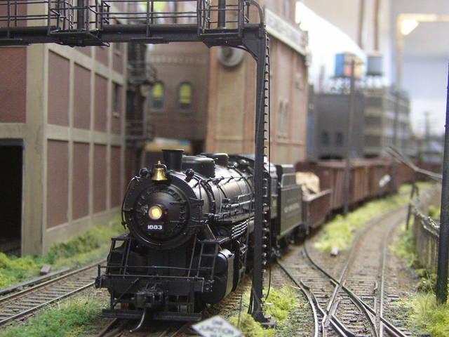

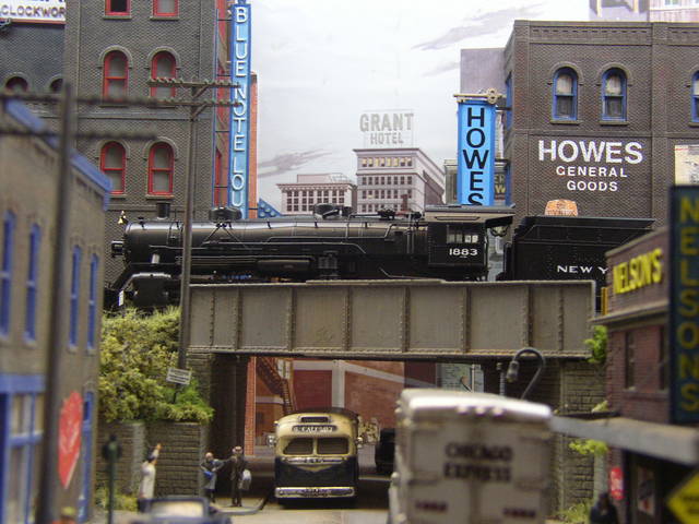

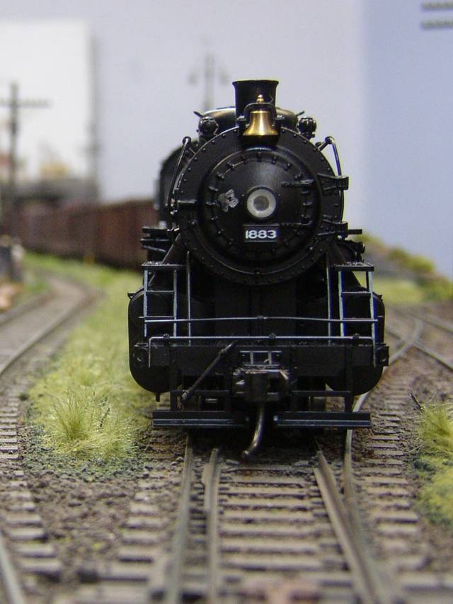

Here are some photos prior to weathering
There’s a plastic shaving attached itself to the smokebox door - I only noticed after the photos were uploaded. D’oh!!
Now for some weathering.
Jon

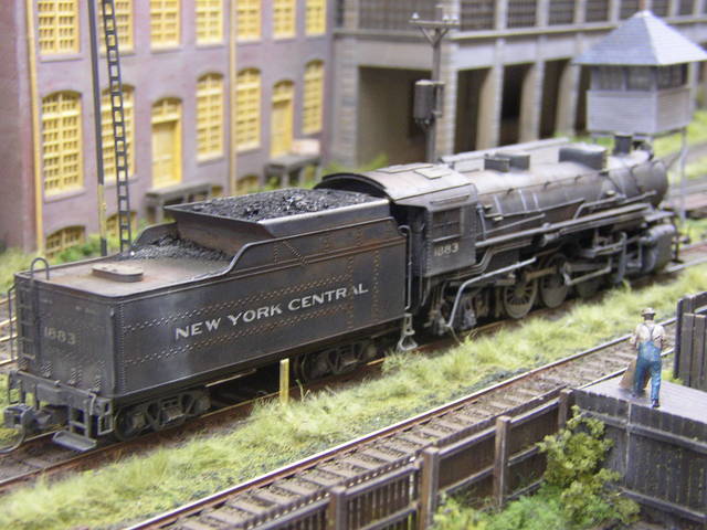

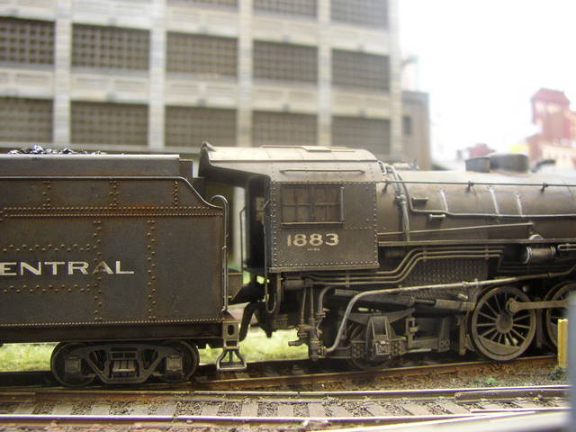

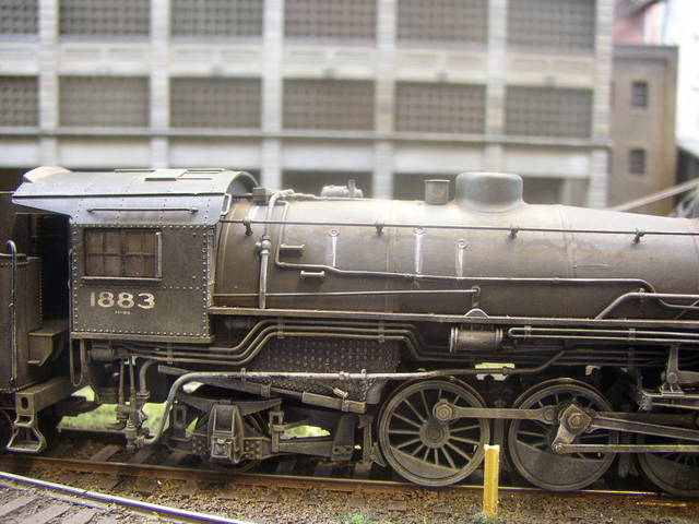

I started adding the weathering tonight.
Jon

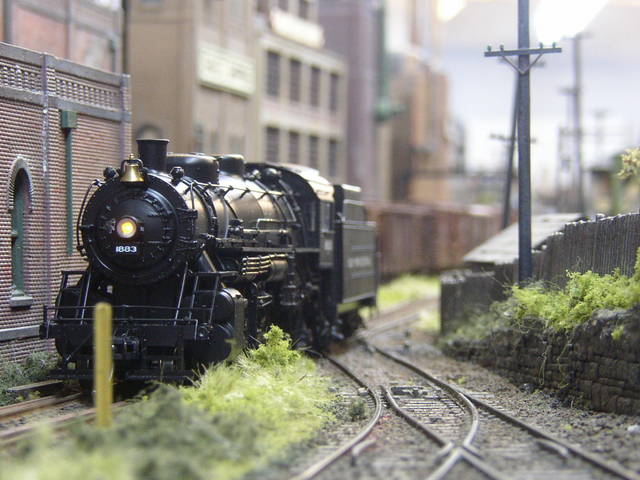

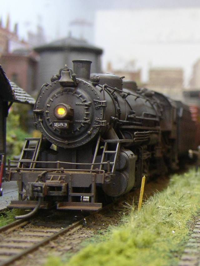

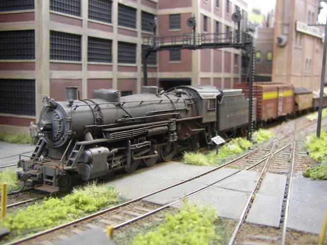

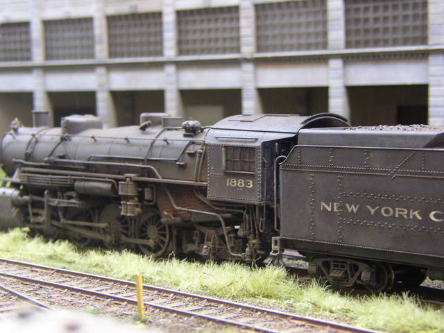

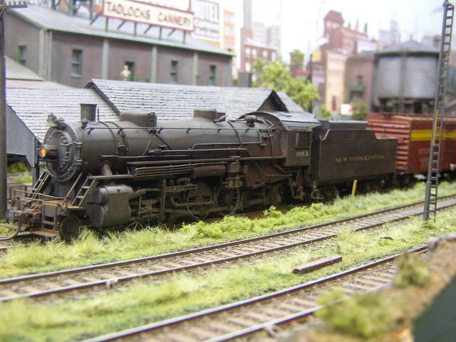

A few more.
I still have to add some water streaks, coal in the bunker, a crew and drybrush a few spots.
Jon

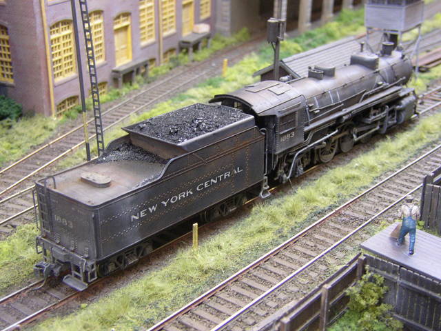

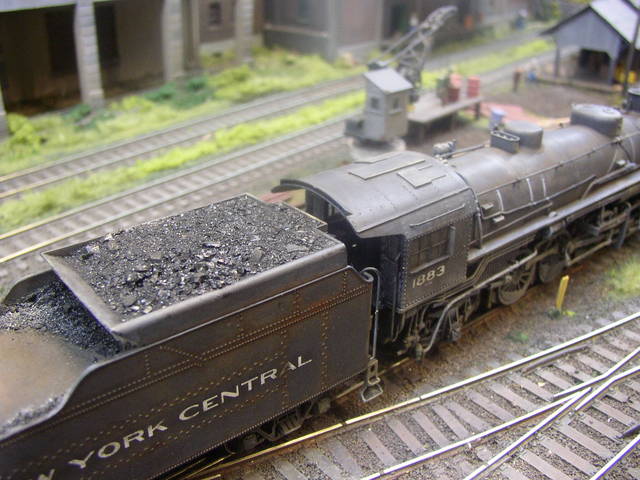

I finished off the weathering tonight and added the coal - you can’t beat real coal for looking like coal.
Jon
GREAT PHOTOS!!! not to mention the weathering job. I like your track work. What kind of flextrack / turnouts do you use? Mirco Engineering? Peco?

Beautiful detailing, as usual. You do nice work! [:)][tup] I especially like the spilled coal behind the bunker. Nice touch!!

[bow] Terrific weathering job Jon! I have the same loco and haven’t had the guts to attack it yet. Coal as coal, PERFECT. But why did you change out the sound system? Were you unhappy with the whistle playing only --o- Other than that I’ve been pleased with it. Thanks for the tip on the front coupler too.
My Trix mike came without either decoder or sound - the instructions suggest that this is how it was packaged, although the hole is present to site the speaker and it comes with the 8-pin socket.
I haven’t got any Loksound decoders yet, but I am very pleased with the medium steam Tsunami that graces the tender.
Jon
I think it was a #35 coupler - anyway it’s the one with the short in-line shank (not overset or underset).
I’ll check it out
Jon
Jon, I really enjoyed your freight car thread and am gathering stuff for a try.
Could you give a little detail on the first weathering steps of the loco? I admit to being more worried about messing up an expensive loco than a freight car.
Hal
Jon, that loco looks great! Very nice work. I’m interested in using real coal to replace the coal loads in my atlas 90-ton hoppers. (This is N scale by the way) Would you mind sharing how you used the real coal? Did you crush your own or did you buy it RTR. What do you use to secure the coal to the tender? Thanks in advance.
