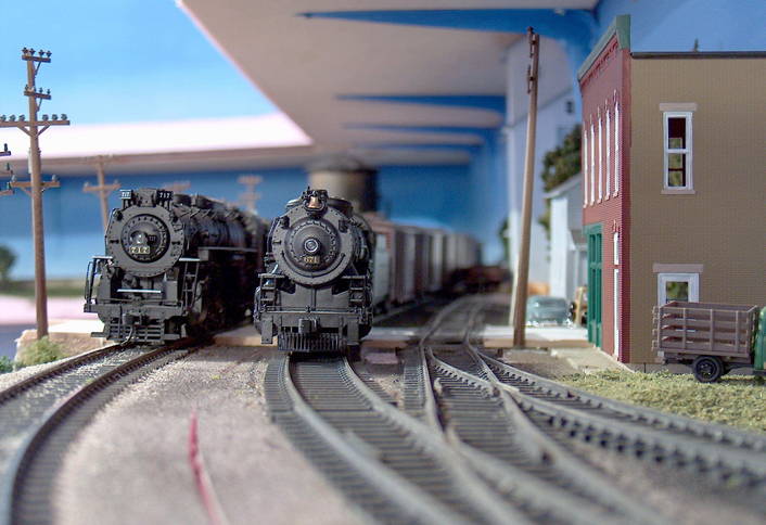

Yes; quite a lot actually. My last layout was a 7x25 triple deck layout, the layout before that was an 8x20 single level, and I’ve built something like 14 Ntrak modules. I’ve also helped design and build three foam-based home layouts for friends. My new layout, currently in the planning stages, will be a 11x25 triple decked, foam-based layout. All of the above layouts or modules have featured at least some track laid directly onto the foam surface.
The above photo shows a section of my old layout, with all the track laid directly onto pink foam. I used strips of 1/2" foam as my roadbed material, laid over a 2" foam base.
Brads or nails will NOT work on foam, as it’s not dense enough for the nails to keep the track in place for long. I did use push pins to hold the track in place while the adhesive was drying, but you MUST glue down track to foam.
I’ve used a variety of products (wood glue, white glue, rubber cement, etc), but I prefer latex adhesive caulk to lay track. Any brand will do, and only use a THIN layer of caulk. The caulk should dry within an hour or two, so you can test the track the same day.
