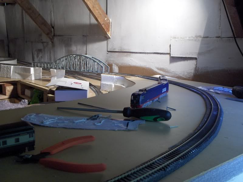

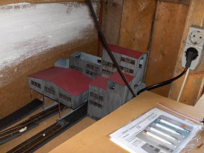

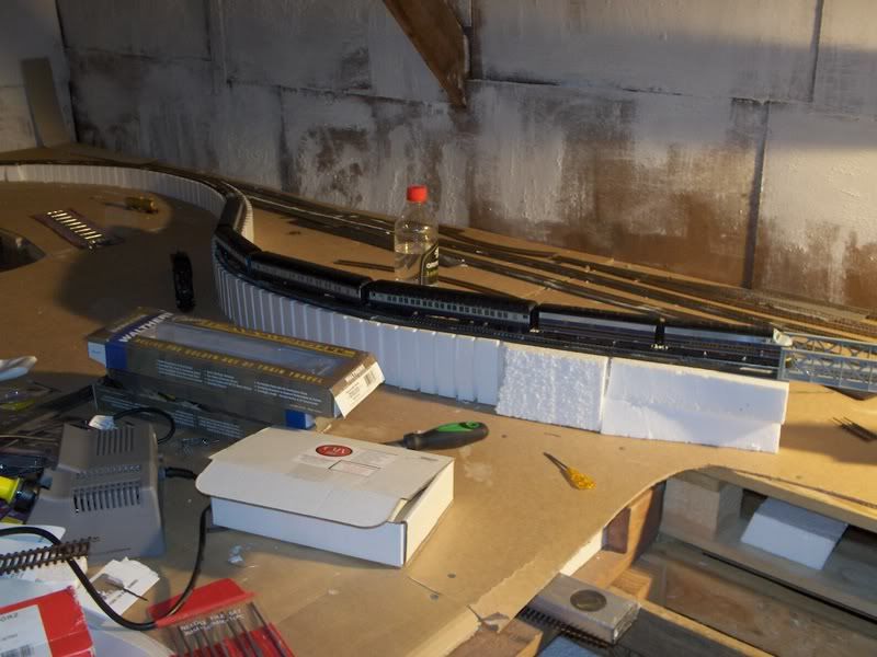

Here are some pictures.
I have been identifying and fixing problem spots. One spot was only a problem for Walther’s heavyweights and nothing else. The most sensitive engine is now officially my PCM Big Boy, my PCM y6b is my least sensitive steamer. The only problem I got with that one is that the contact between the tender and the engine seems to fail on it’s way up hills. My BLI F7 have so far not derailed ones. Hope that holds.
I’ve noticed a Huuuuge difference with Kadee couplers, now the cars actually stick together. There is a lot to learn but I’m moving forward rapidly I feel. One problem spot couldn’t be just altered so I replaced about 15" of track and now the problem is gone. This is fun despite of the issues that arise from time to time.
