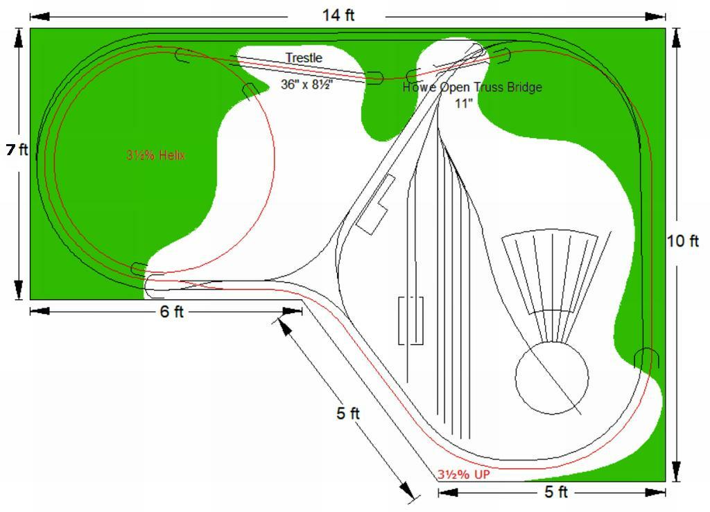

My layout is HO scale 14’ x 10’ using a single 24” radius as my mainline minimum and 30” to 32” for the norm with #6 turnouts. My yard uses 18” and #4 turnouts. All my locomotives and rolling stock negotiate the tight yard radius at slow yard speeds. I have a 3½% grade climbing to 10”.
It has a Wye, Trestle, Howe open Truss bridge, 135’ scale turntable with a 140’ roundhouse and a mainline double crossover, you can do a lot in a small space.
I run large locomotives, Cab Forwards, Y6Bs and E7 diesels with no problems. My longest rolling stock is 72’ passenger cars, longer looks silly on such a small layout but 85’ cars work great.
