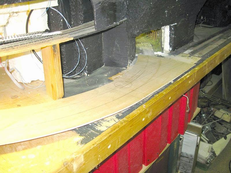

Mechanically only one. I eroded when I designed and built my layout by putting a turnout at a grade transition. I put up with it for years before tackling it about 12 years ago. The only way any of my locomotives would clear the diversion was at almost a creep. Straight through worked OK.
It was a major overhaul under a mountain to move the turnout about 16” to 18”. Took about a week to remove the existing track, redesign and reinstall the turnout and track. It was a PITA but well worth the undertaking, not a single derail since the change at normal running speeds.

It was a real task working in the tight spot. Going back and looking at pictures the actual turnout really wasn’t moved very much, the entire corner tracks were overhauled moving both mainline tracks reducing the radius to the inside track to 24” from 26” and moving the transition 16”.
It seemed like removing the old track was more difficult than installing the revised section.
The solution was moving the actual transition touchdown point 16”.
The ¼” plywood section tapered to a paper thin transition took more work than any other part of the fix.
I put up the problem for 25 years because of the location. I still remember how much trouble it was to make it perfect but it was worth every minute of labor and pain it took. I haven’t had a single problem since the overhaul in 2014.

I’ve always been a lone wolf and back in 1988 when I did the design of “my dream layout” I didn’t know that putting a turnout at a grade transition was a no no. I never did much research other than the MR or RMC magazines. Self taught model railroader since 1951 at 14. My model railroad mentor was John Allen and I didn’t see any info about the “Don’t” put a turnout at a grade transition anywhere.
It was only after I bought a few newer locomotives in the mid 90s that the turnout problem surfaced. My Roundhouse 0-6-0 (1951), Bowser Big Boy (1963) and my two Athearn four axle diesels (1975) didn’t have any problems at the “bad turnout”. When I added a few newer six axle diesels the turnout became a serious problem.
I was able to tweak the Athearn six axle diesels to work at reduced speed and one Model Power E7 never had a problem, Proto six axle diesels wouldn’t even creep through the diverted turnout. My Rivarossi Cab Forwards pilot wheels would sometimes derail at the turnout.
After the fix everything works. I can’t remember having any derails on my layout since the fix.
