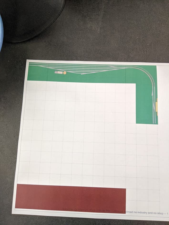

Hello i am looking for help designing a layout in a 13’ x 12’ room with a closet on the left of the door and a loft bed on the right wall against the back wall. Also i want to have a helix but its not really doesn’t matter if it has one or not but i would like to run 20 or 18 car trains with some passenger ops. but due to me having a desk on the right wall and my mom having crib in there for her daycare that is in the middle i only have the option of the back wall and right wall for benchwork so I would really appreciate some help with getting some ideas.

Yes, space is tight. You might want to look around on the web for ideas. There are a few sites out there with layout plans.
Looking at the space, I assume you don’t really want to do significant operations. I would see potential for a switching layout, with a few modifications to your plan.
Here is a thread that provides an example of a switching layout:
Track plan for a small switcher - Model Railroader / Layouts and layout building - Trains.com Forums Track plan for a small switcher - Layouts and layout building - Trains.com Forums
Otherwise, you might want to consider not having a yard and have a longer point to point layout for a short passenger service. Less track will create the illusion of a longer mainline.
Simon
your room’s limitations doesn’t provide much space for much of a layout. A 20 car train is ~9ft long and minmal helix with 18" radius curves and 4+% grade is at least 3 ft square.
Simon made a reasonable suggestion. There are many other small switching layouts that may fit within your room
