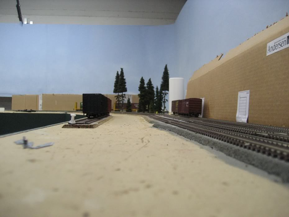

My layout room is a somewhat odd shape, with most of the layout following the walls. Width varies from about 20" to 42", with all track within easy reach. For the most part, lighting (twin tube 48" fixtures above a suspended ceiling) follows the layout and is over the layout, albeit very close to the aisles - that way, operators cast no shadows on the layout. The peninsula area, because of its shape, was somewhat harder to follow with the light fixtures, but seems to be fairly well-lit. I’ve added two fixtures since these photos were taken, which added much needed illumination at both ends of South Cayuga. Here’s a sketch of the room:
In the sketch above, the areas in grey will eventually have a second level built over them, with lights mounted on its underside to illuminate what’s in place now. These will be the same type of fixtures, spaced roughly the same as what’s in place in the ceiling.
This is the Dunnville area, with part of the peninsula visible at right. In the left foreground is the corner at Lowbanks, and, just visible above that at the left side is part of the staging yards. There’ll be another one built above this when the second level of the layout is built, also with lights on its underside to illuminate the yard shown:
This is the South Cayuga area, looking back towards Dunnville (out of sight around the corner). I’ve since added a light in the second ceiling panel out from the far wall, with its right end about 2’ from the wall at right. The Speed River is behind the camera.
South Cayuga again, looking in the opposite dire
