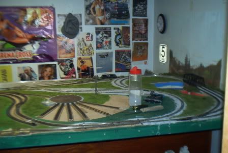

heyy guys for some reason my layout is horrible lately. ever sense i started ballasting tracks dont work trains derail engine wheels grind and it just doesnt work. heres some pics i think i need too clean my track any ideas too clean track with? any solutions too my problem? thnx keith.

It looks like you glued ballast to the tops of the crossties and insides of the rail. Ballast should not cover the crossties. Take a small flat blade screwdriver and run it along the insides of the rail to dislodge any ballast that is on the rail. It sounds like your wheel flanges are hitting chunks of ballast as your train runs around the layout.
