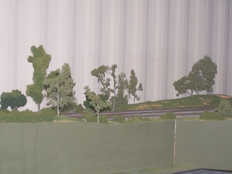

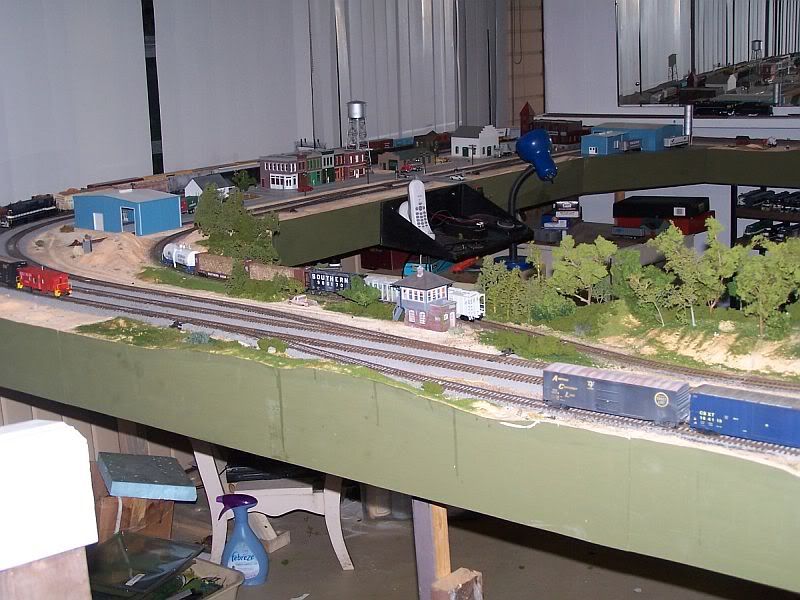

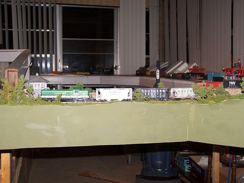

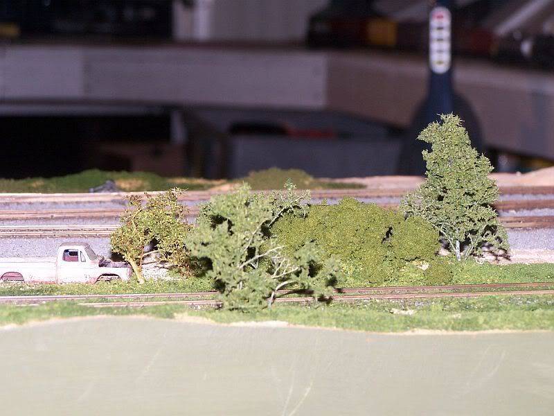

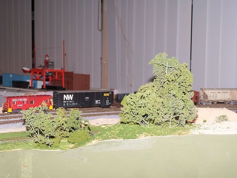

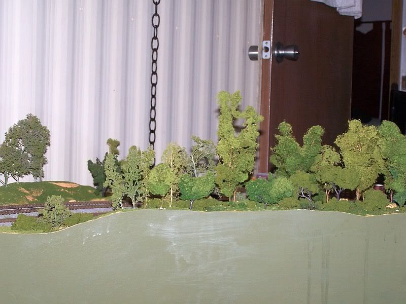

I have always liked super detailing locomotives and rolling stock and never was much into doing scenery. Working on my own layout now and adding hundreds of trees to a former desert layout has finally got me into doing scenery. One source of my trees is Super Trees. It’s somewhat time consuming to separate out the best candidates, pick out the thin leaves and unconnected branches and then strengthen the trunks where necessary with super glue. After doing that I mixed a batch of acrylic paint to a gray-green color and airbrushed the armatures. The next day I sprayed the armatures with cheap hair spray and dipped the armatures in a mixture of various shades of loose foliage and turf. Here are the results.

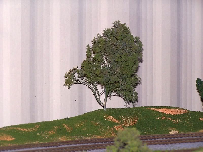

With regard to the flocking of the tree armatures, it really shouldn’t take “a ton” of ground foam foliage to do the job on a large number of trees. I can cover a huge number of trees with just a single quart-sized shaker bottle. The mistake most hobbyists make is applying way too much ground foam in making their trees. The lighter and airier they are, the better and more realistic they will look. In the real world one often sees a lot of the tree’s branches and it’s not uncommon to be able to see straight through parts of many trees, as you’ll note in the image below. There, most of the
