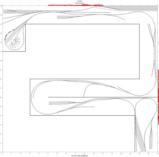

My train room is a newly finished basement addition that is heated by two electric baseboard heaters each 6 feet long. I am leaning toward an around the wall design with a peninsula but now I am concerned the bench work will cut off the air flow from the heaters.
The red is the location of the baseboard units. Does anyone have any real world experience with this?
Assuming that the baseboard heaters are down near the floor, and the layout height is as least waist-level, this should not be a problem. You should, of course, not build cabinets or under-layout shelving above the baseboards. Let them have free airflow both above and below the heaters.
As drawn, your layout may actually improve the heating characteristics of the room. Heat rising from the baseboards will be directed outward from the wall towards the center of the room, which is where you want it.
I don’t see any real problems with your design provided you have enough airflow to and from the heaters. I would suggest a baffle of some kind to direct the heat toward the center of the room so it does not pool up so much under the layout and cause expansion/contraction problems directly over the heater. A simple angled sheet of masonite or something should do the trick.
I’ve seen these heat/cool expansion issues on my garden layout where the sun shines on one part of it in the morning and the track flexes as much as 2" in that area only(naturaly this is within tolerance). I don’t expect that 2" of expansion is built into your design[;)]
I actually had a similar problem, that I wasn’t sure how it would affect the heating/cooling in the room. My layout is around the walls, very similar to yours, but it’s located in a finished bonus room above the garage. It has two a/c vents, and one large return. One vent is ceiling mounted, on the far side of the room from the return, and the other vent is on the same wall as the return vent, about 1.5 feet from the floor. My layout height is apprx 40 inches, and I was really worried that it would severely block the airflow in the room. I installed a ceiling fan for safe measure, but I really haven’t needed to use it except in the dead of summer (Georgia summers can get pretty hot, and the fan helps circulate the air throughout the room). In the winter, the heat does seem to stay nearer the floor, and is very comfortable to work in the room.
I agree. Leave a clearance aperture in front of the heaters and the rising air will be deflected by the bench and move outward. So, place nothing in front of the heaters, except for maybe a shallow fascia. Let the air come in along the floor toward the element and let it flow back out skimming the nether surface of your bench.
A better solution, if you could manage it at all without compromising your plan overmuch, is to cut a 2" slot in the rear of the bench directly over the heater, and allow some hot air to escape up through it. It needn’t be the full length of the heater; maybe just 2/3 of the width if that will save a track for you.

One ceiling fan mounted in the center of the room with the blades rotating in the direction that blows air upward, running at its slowest speed, should create enough air circulation to suck the hot air from under the layout and spread it throughout the room. If you plan to put a skirting around the layout, you must leave gaps for air circulation.
Our house was built originally with electric heaters. We switched to forced hot water when electric rates got rediculous in 1996. But for small added rooms, electric heaters are quick to install, and nearly 100% efficient, quiet, and never fail unless abused. Ours were all working great after 30 years of use. Now for your concern. As we all know, heat rises towards the ceiling, and you do not want to restrict that flow because it leads to hot spots and cold spots in a room. If you have a train table sitting over the top of the heater, the only way the heat can rise is to flow up under the bottom of the train table, and then flow outward towards the open area to where it can freely rise to the ceiling in a curling motion. I have tested this with smoke sticks. It is not recommended that you cover these heaters with your tables, as you will be restricting the flow of heat considerably. You could use a ceiling electric heater up in one corner, that uses a blower to direct the heat downward with adjustable fins, or, use your planned floor heaters, but on open walls with nothing above them. Or, pull your table back about 4" from the wall/s to allow for heat to rise properly.

Pulling away from the wall with the staging should be easy I can just shorten the straight track in “Bethel”. The second wall I think if I can leave a 2 inch gap plus open up the bench work behind the curves, maybe bringing the backdrop close the track.
If all that fails I can put in some computer fans to get the air moving. I am glad everyone thinks this will work. At least that the heat will work.

Your track does not hug the edge of your layout above the entire baseboard heater length. If the edges of your layout hugged the track instead of the wall, you wlould be creating natural vents which would allow the air to circulate naturally instead of building up under the layout.

I think the area behind the track near the peninsula is a prime candidate for ventilating. On he other wall it is just so easy to move the entire layout away from the wall to provide air space, my wife frowns on attaching anything permanently to the wall so the layout will be free standing anyway.
