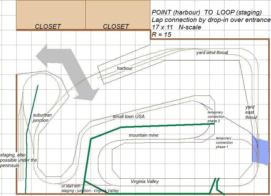

This plan for Sora might give you a better idea about phases. With the red line, temporary connection phase one, you will have a donut style oval, with 2 stations. If this is finished the red connection will be removed and the blue one added. The resulting layout functions as a loop to loop design. And finally the yard and harbour can be added.
Have fun
Paul
