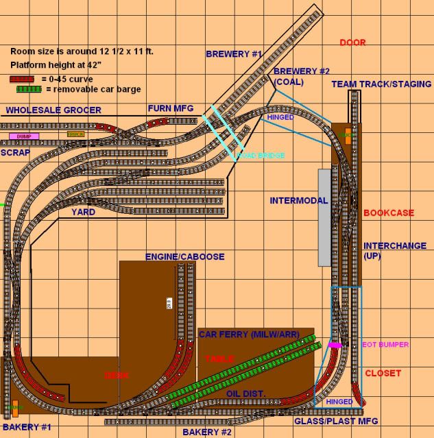

Here is my layout-in-progress. It’s modeled after an industrial area with lots of tightly packed track and industries. I didn’t have much room to work with and I had to work around furniture that needed to stay where it was. As you can see, there isn’t much room for buildings on the layout so I am using a lot of background buildings and flats but I do have room for a full passenger station, platforms, small tank farm and switch tower. For me, this is a very fun layout for operations. The loop is connected so I can also run a train around me while I’m using the computer at the desk. Careful study will show that there appears to be extraneous switches in a few places. These allow for the creation of two passing sidings on the layout when running trains in circles. (One in the yard and the other by the Oil Dist./Intermodal area.) I use RailOp with this layout to generate my switch lists. Curves are O-54 unless noted.
