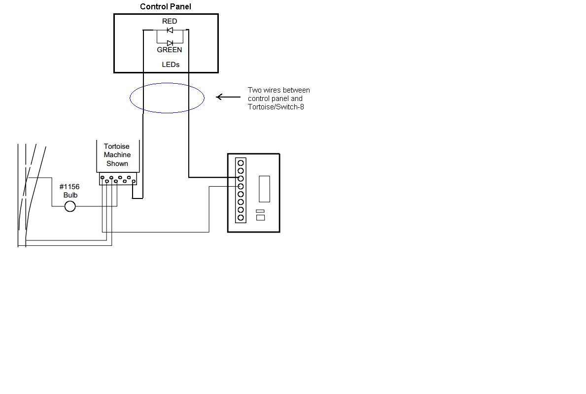

i think your current wiring is similar to the diagram below, the tortoise motor is driven thru the LEDs

in the switch-8 Accessory decoder manual doesn’t the diagram on page 4 show you how to wire up the LEDs similar to the way you currently do?
The diagram shown in the manual shows the LED connected between the Tortoise and the stationary decoder (Switch-8, Switch-It) and those two devices are very close to one another.
My problem is that the control panel is about 6 to 8 feet from these devices, and I don’t have a continuous, uninterrupted source of DC power nearby. So, I am forced to string wiring from the Tortoises to the control panel where the LEDs will be located.
So you like a way that a pair of wires for each Tortoise can drive a pair of LEDs to indicate the Tortise position?
greg, I’m not sure what you are asking?
Unless I’m missing something, I don’t see why you can’t use the diagram in the Switch-8 manual. You have the bipolar LED at the control panel(the manual shows two separate LED’s in parallel, but that is what the bipolar package is). You have two wires running from each Tortoise to the control panel. You’ll have two wires from the Switch-8 to each tortoise. Use the two wires going to the control panel two splice the LED into one of the wires going from the Switch-8 to the Tortoise. It doesn’t matt

to re-use your 2-terminal bi-color LED, you would need 2 wires where the voltage on those wires can be reversed. You could wire from the switch-8 through your 2-terminal bi-color LED and back to the Tortoise. Apparently this is not desirable
You can use a 3-terminal bi-color LED, single-ended DC supply and a Tortoise SPDT. The DC (+) supply can be wired to the common SPDT terminal (4). The other SPDT terminals (3&2) are wired to separate LEDs. The common LED terminal is wired thru a resistor to the DC (-) supply. 3 wires are needed between the panel and each Tortoise.

I did look at that diagram in the NCE manual. That would certainly be a solution for the continued use of the 2-leg bi-polar LEDs but, given the distance from the Tortoises to the control panel, I would either have to relocate the Switch-8 to the control panel or bring two wires to the control panel from the Tortoise and 2 more wires back to the Switch-8 if I wanted to keep it close to the Tortoises.

There would be no reason to run two more wires. Here is a diagram showing how to do it:
Oh, I see my error in thinking that I would need four wires, two to the control panel and two back to the Switch-8. Duh, I would need just one to the control panel and one wire back to the Switch-8. I don’t know why electronics is so hard for me to grasp.
I need a simple drawing program so I can make pretty pictures, if I draw it with Paint it looks like a crayon drawing. Anyway, what I was getting at is that you cna continue to use the saem 2 leg LEDs and just run ONE wire from the Tortoises back to the panel. You need a bipolar power supply, like the one option shown in the Tortoise diagrams for using a SPDT toggle. The + and - lines from the power supply daisy chain to each Tortoise, pins 2 and 3. Pin 4 of the Tortoise is the one wire you run back to the panel. You also run the common lead of the power supply to the panel - ONE time, and daisy chain it to one side of each LED. The one wire from pin 4 of each Tortoise goes tot he other leg of the specific LED for that turnout. You will need to add a resistor to each LED as well. But, the two lead bicolor LEDs stay.
How this works is, when the Tortoise is one way, it connect the LED between the negative and common. Common therefore is positive, relative to the negative side. So whichever color LED inside the bicolor LED is wired that way will light up. Move the Torotise the other way, the leg of the LED connected to the Torotise is now positive, compared to common, which is eacatly the opposite polarity, so the other color LED inside there will light up.
It really works. You can test it - take a pair of 9V batteries. Connect the + of one to the - of the other. This is your common point. Hook up a 1K resistor between this common point and one lead of the bicolor LED. Touch the other lead to the free + terminal on one battery - it will be red or green depending on which way you hooked up the LED. Now touch that LED lead to the free - terminal of the second battery - if it was red, now it will be green, or vice-versa.
