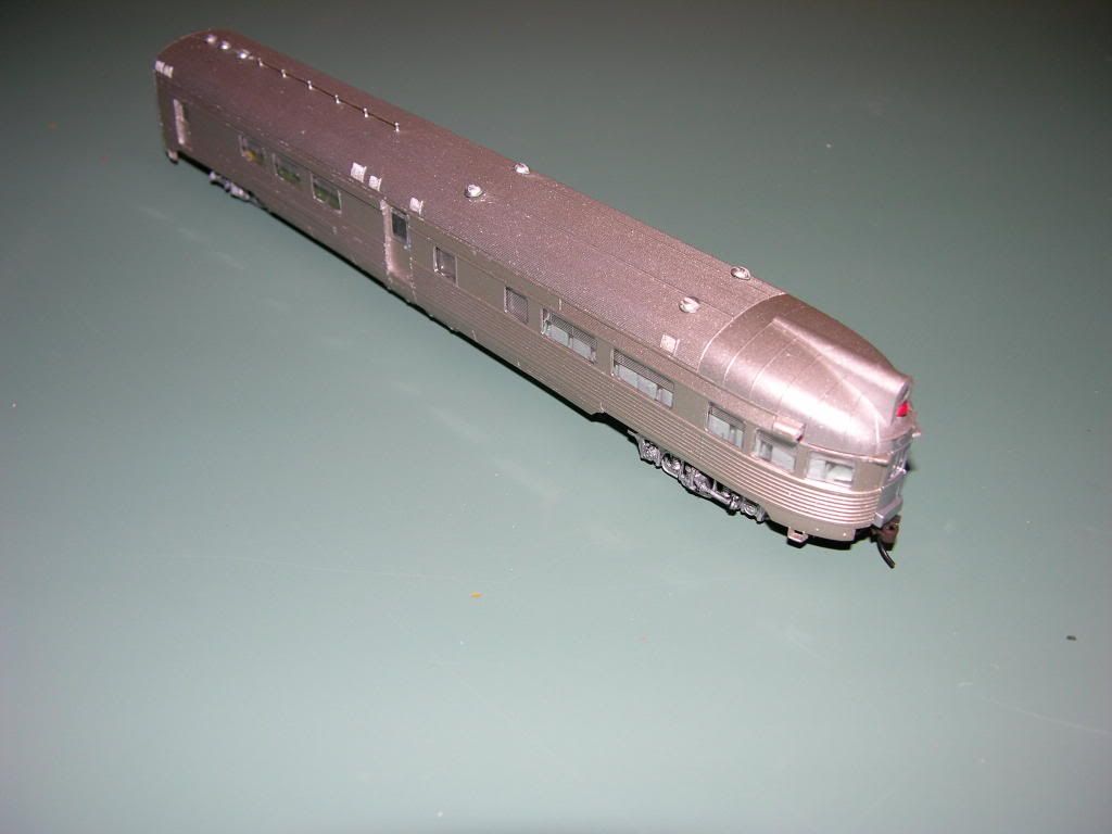

Here’s the lighting for my kitbashed observation car, Silver Fountain. CB&Q owned four observations of this type. The cars were built prior to WWII, and they had a vestibule with entrance doors in the center of the car. Pictures show the doors are recessed into the car instead of being flush. The forward section provided diner car service, and the rear section provided parlor seating.
This was an ideal prototype for me because I operate short passenger trains, and of course, my primary railroad is Burlington.
My kitbash is based on the Walthers Budd observation car. Windows and doors were re-arranged to match the prototype.

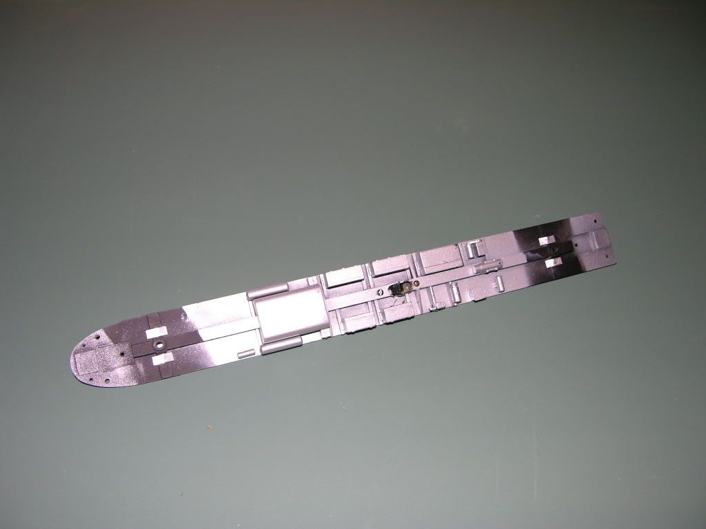

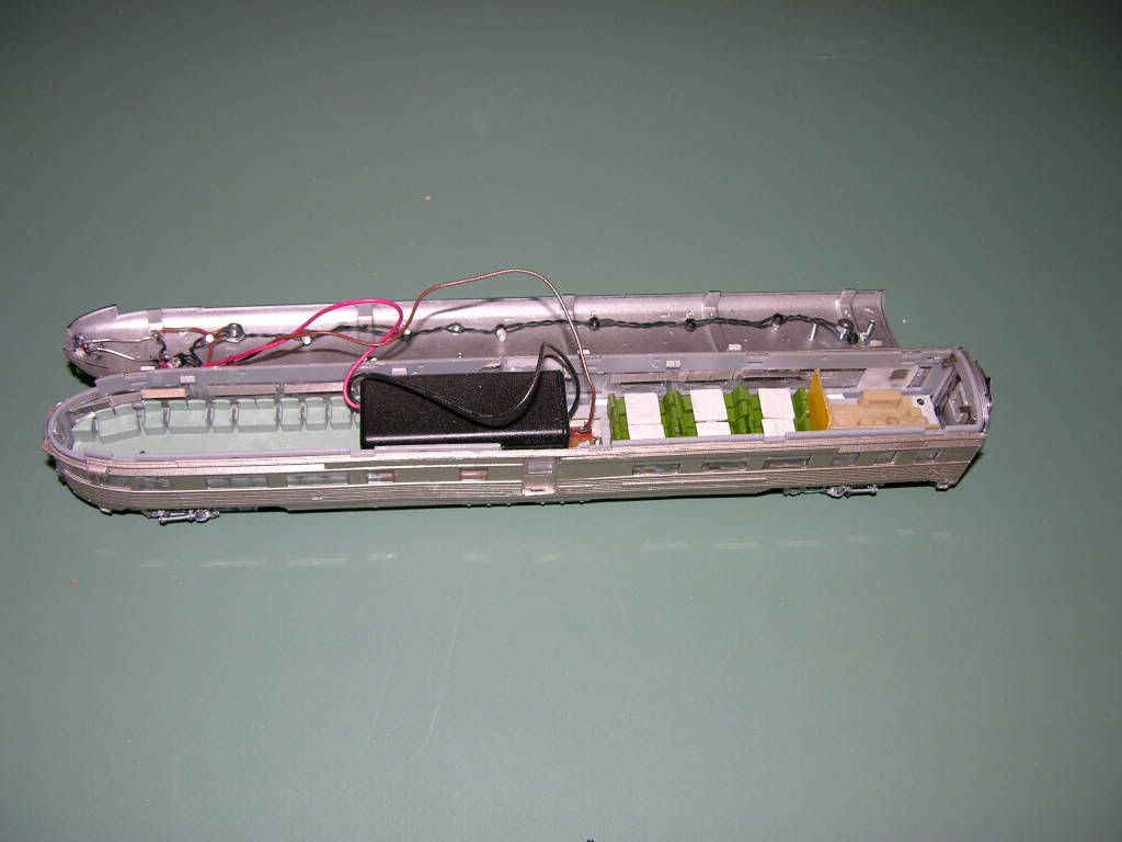

Interior lighting is cut from a sring of Christmas tree lights. The string of lights purchased at a post-Christmas sale (75% off retail) made an affordable source of three volt LED’s. The rear light is a three volt red light commonl available. Power is from a twin AAA battery holder. A small toggle switch is mounted in the floor. The switch is operated from underneath the car.
