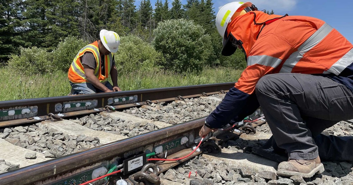

Carriers, NS included, are continuing with installing many detectors to catch the many kinds of defects in trains that can result in catastrophic derailments. Hot box detectors, both IR detected temperature units and ultrasonic detectors, WILD (Wheel Impact Load Detectors) to detect flat spots. There are myriad of other kinds of detectors that have been installed.
On CSX the Hot Box and dragging equipment detectors radio the results of their inspections by axle count to the trains over the road channel that trains are required to monitor; the HBD data is also attached to records in the Car & Train Movement databse for trending indications…
WILD detectors send their data to the HQ Mechanical Dept. who monitor the readings which are identified to them by the RFID detected car number; when an over the threshold reading is identified the Mechanical Dept. notifies the Train Dispatcher & Chief Dispatcher where the train is for the crew to stop and inspect the identified car(s). If a level 3 defect is indicated, after inspection the car(s) can continue to destination, not to exceed 30 MPH. If a level 4 defect is indicated, after inspection the car must be set out at the first available set out location. The WILD detections for a car are retained in the Car & Train Database with all car movements of cars on the property. There are Levels 1 & 2 that note a minor happening that does not require field notification or actions.

CSX has been actively building ‘Super Detector’ sites around the property which includes a number of under car sensor for a variety of inspections for items that cannot be done with normal ‘above ground’ inspections.
When I initially went back to Dispatching in 1990 the HBD detectors were spaced at the FRA specified minimum of 25 miles apart. Over the years until my retirement in 2016 additional detectors were installed so the the detectors were on the order of 10 to 15 miles between detectors.

Note the relative importance of the integration of data from the WILD IV installations. This provides realtime assessment by car and axle number for a variety of conditions, not just shelled/flattened wheel tread. It is obvious to me that this or similarly-derived data are in use by some entities, including whoever is doing maintenance for the unit coal trains operating on the ex-Southern line east out of Memphis – they have a dramatically low rate of even slight flats, as do many of the long doublestack block trains.
