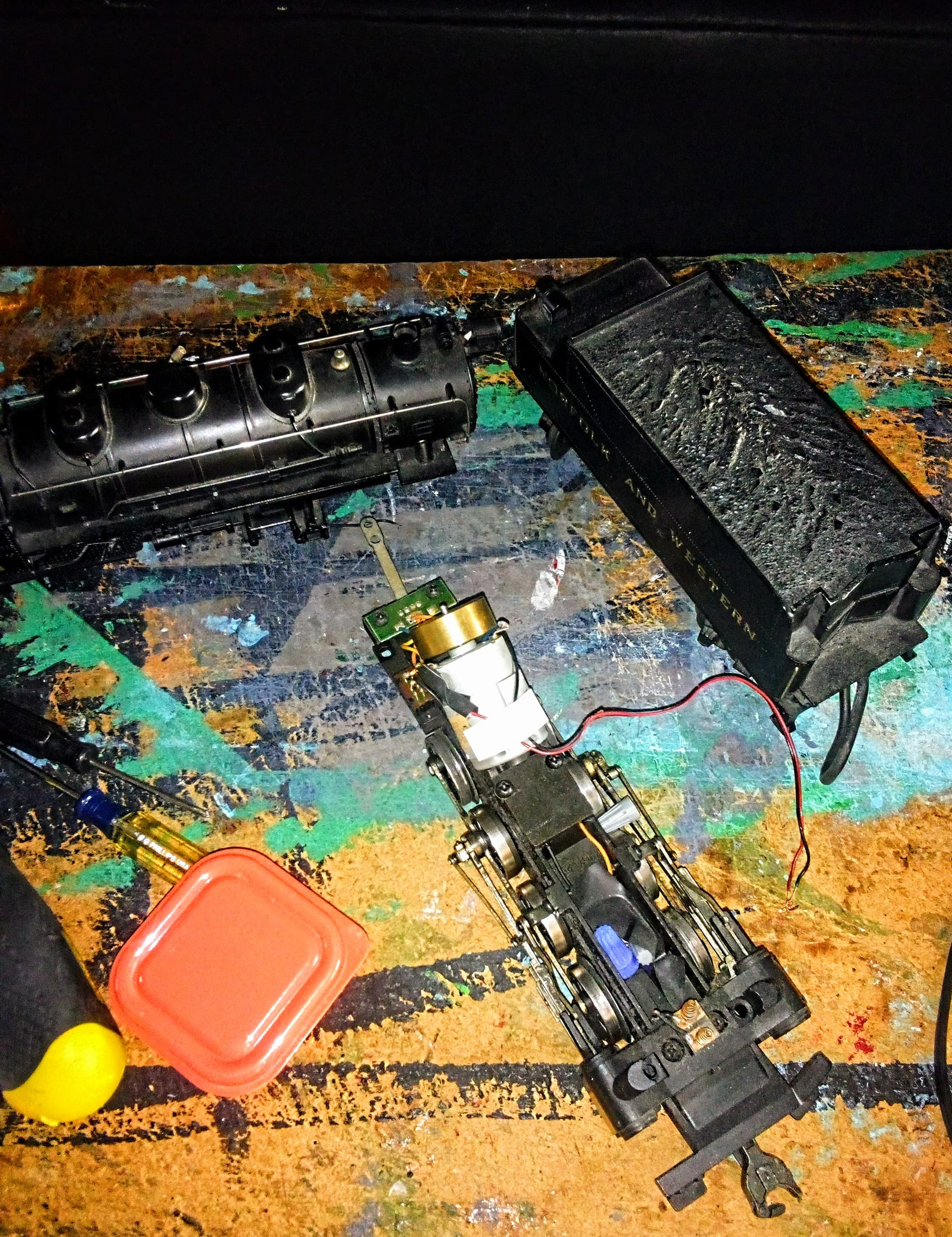

As long as the motors are good you can always:
  1. Pull all the boards out, wire the motors directly from pick-up to ground and run them conventionally off a DC transformer.
  2. Install a drop-in conventional control board and run it off an AC transformer.
    The possible long-term issues are why I want a conventional control fall-back. No offense to remote-only control products if people like them but I won’t touch them, I want that fall-back option.

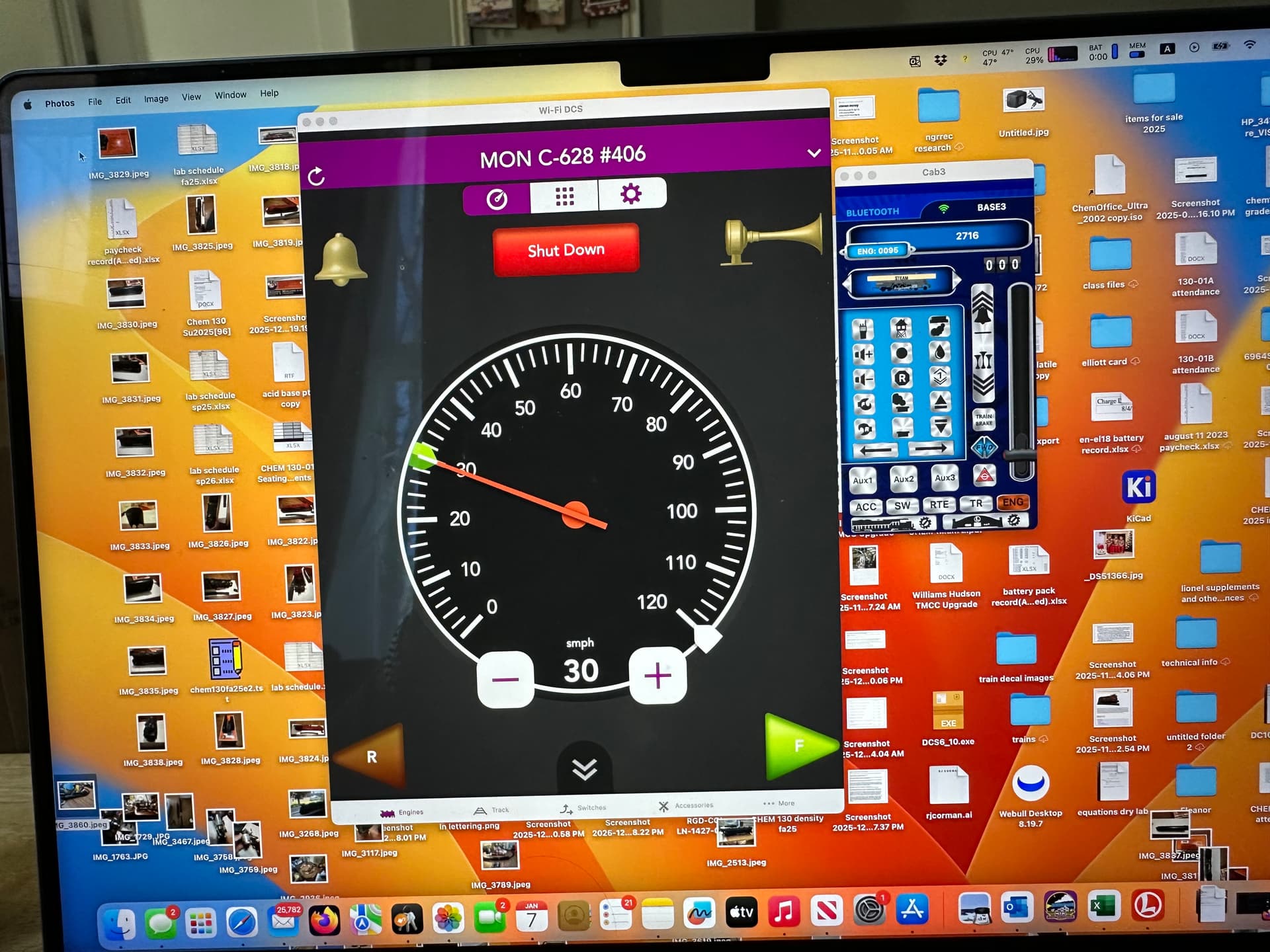

Unless there is something I’m missing, the DCS remote can also set the engine speed in fine increments as described above. I’m not sure what the phone adds in that regard?
I do realize the DCS remote is no longer readily available however. Is it that CTT now tries to do the reviews using the app, since that is what’s readily available to anyone reading the reviews who may be starting at square one with a new purchase today?

The DCS remote will do everything a phone will do. The same is NOT true for Lionel Legacy. The new advanced Legacy features can only be accessed with a combination of a Base 3 and the Cab 3 App running on a cell phone. This is unrelated to Bluetooth.
