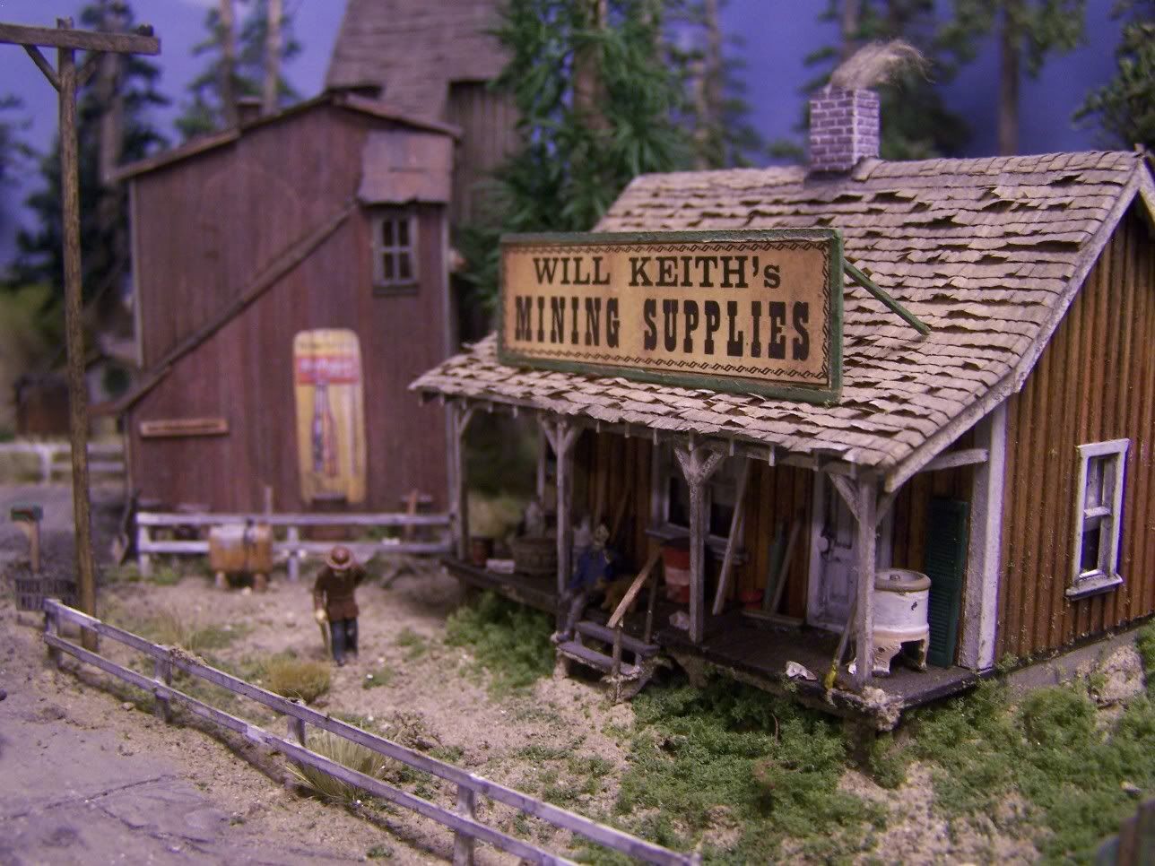

It’s hard to beat Campbell’s rolled shingles when it comes to roofing a structure. However, there are a few tricks I have learned to make them look a whole lot better. First, I attach the rows of shingles using Elmer’s glue, applying the glue to only the upper half of each row. Like already mentioned, I run each row past the edge of the roof card then trim them flush with a pair of sissors. Once the roof is covered, I spray it using Floquils earth. Once dry, I apply a wash of A&I stain to tone it down and weather it. I then randomly lift some of the shingles with a hobby knife (hence the reason I only glue the upper half of each row). Lifting shingles really makes them stand out. Finally, I dry brush (Reefer White) to provide some highlights.
Here are some pics showing this technique applied to my structures:
