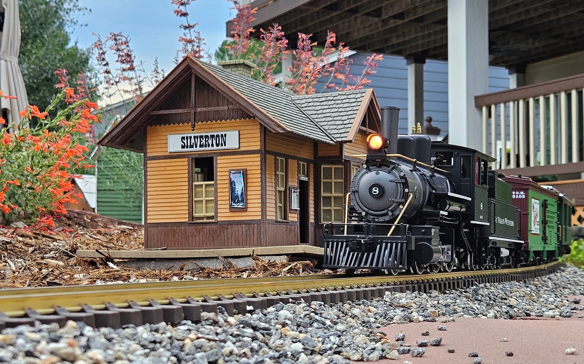

I ended up going a bit more costly route and installed a Piko RC board. A higher cost, but the Mogul is a remote operated engine now albeit still running on track power.
And it looks great, too ! Glad it worked out.
Paul
Thanks, Paul! Happy to have it back up and running again.
