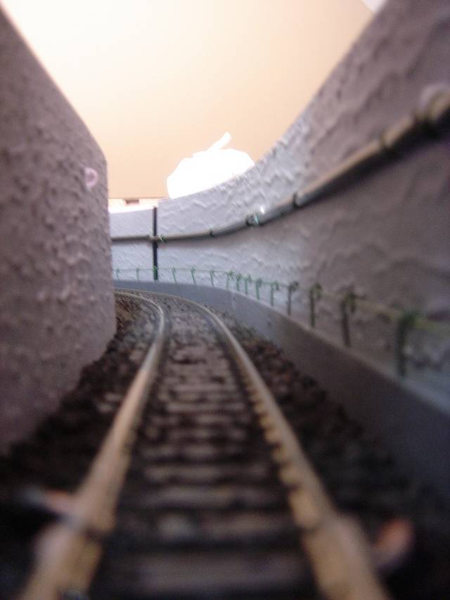

The LION also has LEDs on his subway walls. On mine the entire LED is inside of the tunnel with each leg piercing the foam wall through a separate itty bitty hole. One is bent up, the other down. A glob of silicone caulk is then added to the LED and a snip of plastic is set in place so that the light does not blind the oncoming motorman.
The bright light here, is actually a blue LED marking the location of the emergency exit, telephone and Emergency Power Cutoff.
