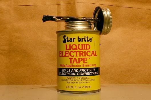

Try applying some of this Liquid Electrical Tape (actually a vinyl paste) over the seam inside the shell where the light leaks out:
Thank you both! I’m going to try R. T. Poteet’s method first, because I have the materials to do it. CSX_road_slug, i’ll try your solution if R. T. Poteet’s method doesn’t solve my problem. once again, thank you both!
