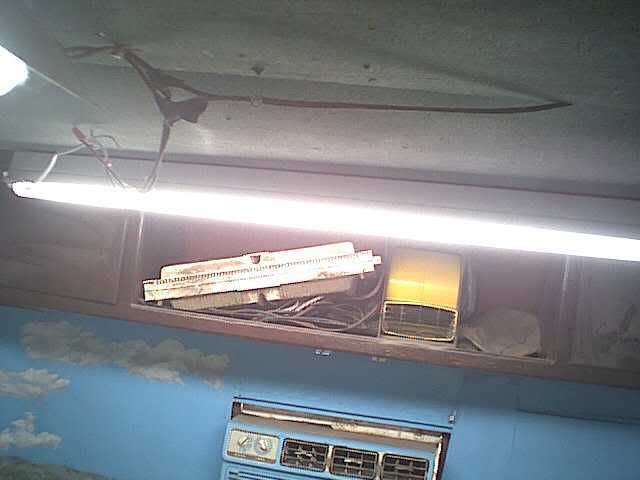

I wouldn’t know how they look over a layout, as I have no incandesant light fixtures in the front of my trailer. However, my father uses them in his library. To me they look to have a glare that I don’t like. I use all flourescent lighting over my layout. The bulbs I use are called “Sunshine” bulbs and are a tad expensive but the light is very close to natural light and the colors really stand out.

I went to Wally world and got a 2 pack of each floresent they sold. (daylight, bathroom, kitchen, shop light) Some were too pink or blue or green looking. I kept the cheap 25 watt shop light bulbs. I thought they looked the best. I didn’t try those $6 ones Jeffs talking about. I understand the ballast in the fixture has a lot to do with it too. Those spiral ones probably won’t throw enough light to do the job.

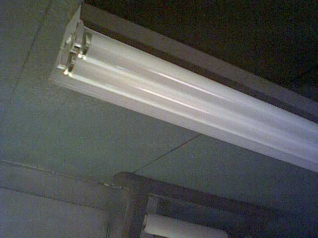

If the ballast units have a lot to do with it, I’m in big trouble. I use standard Shop-Lite fixtures with the factory installed ballast units. No vibration, no buzz, no flicker.
I’m just using shop lights too. I’m having to replace mine after about 1 year of use. (that’s getting old) I remember a long post about 2 years ago where a lot of people said they were using some kind of expensive ballast that gave off a better light and lasted longer. I know one person mentioned them and a whole bunch of folks jumped in and said they used the same ones. Something about a better color and they didn’t give them headaches.[%-)] I remember they were about $25 each.

One year! Are you referring to the fixtures? Mine are over 6 years old and still going strong.

Yep. Fixtures. They work fine for about a year and then the life of the tubes goes down REAL fast. New tubes only last about a month then. Might have something to do with the temp. extremes in the train building. Think I’ll buy better ones at Home Depot next time around.

The “shunshine” bulbs Jeffery is refering to are GE’s brand name for their 5000 degree Kelvin full spectrum bulbs. As other have said you can find them at many stores in an orange cardboard sleeve. In other discussions you might see them refered to as “Chroma 50,” which is GE’s brandname for the same bulb in industrial applications. Sylvania makes a similar bulb they call the “5000K.” These bulbs don’t require special ballasts beyond making sure you’re using a T8 bulb with a T8 ballast or a T12 bulb with a T12 ballast. Both types are 4ft. tubes with bi-pin ends, but T8’s are thinner in diameter than T12’s.
